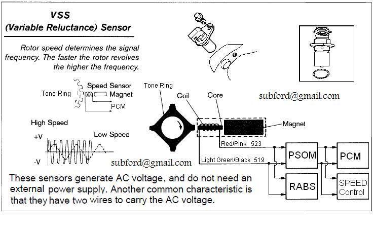

I'm no Ford expert either, but here's what I think I know based on my research. Please correct me if I am wrong. BTW, I have no plans to replace parts yet, I am just trying to diagnose at this point.
Code 452 doesn't necessarily mean that the VSS is not putting out a good signal, it means the PCM doesn't like the signal that it's getting from the PSOM.
Continuous Memory DTC 452 indicates the PCM detected an error in the PSOM output signal during the last 40 warm-up cycles.
Possible Causes:
-- Damaged Rear Anti-Lock Brake Sensor (VSS).
-- Damaged PSOM.
-- Damaged harness circuits.
-- Damaged Powertrain Control Module (PCM).
The VSS signal drives the speedometer and the RABS, the output of the PSOM goes to inputs for the speed control module and the PCM.
The RABS module /computer can weaken or corrupt the signal going to the PSOM, disconnecting the module could restore the signal to the PSOM.
The speed control module / computer can corrupt the signal coming from the PSOM and going to the PCM, disconnecting the speed control module could restore that signal.
IIRC, I have seen where subford (member of this group who seems to be pretty knowledgeable) has said that if the speedometer works correctly, that is an indication that it is getting a good signal from the VSS which makes sense to me based on what I think I know about the system. Of course it would be good to verify that, but I dont have an o-scope. The best I could do is measure the signal with a voltmeter.
At this point I wouldn't eliminate the VSS signal being bad, but it doesn't seem likely to me. I need to test drive and verify that the speedometer works correctly, the RABS works, and the speed control works. The only problem I can think of with my plan is that if the fault is intermittent, my tests could prove nothing, but no testing will prove anything if the fault doesn't happen during testing.
