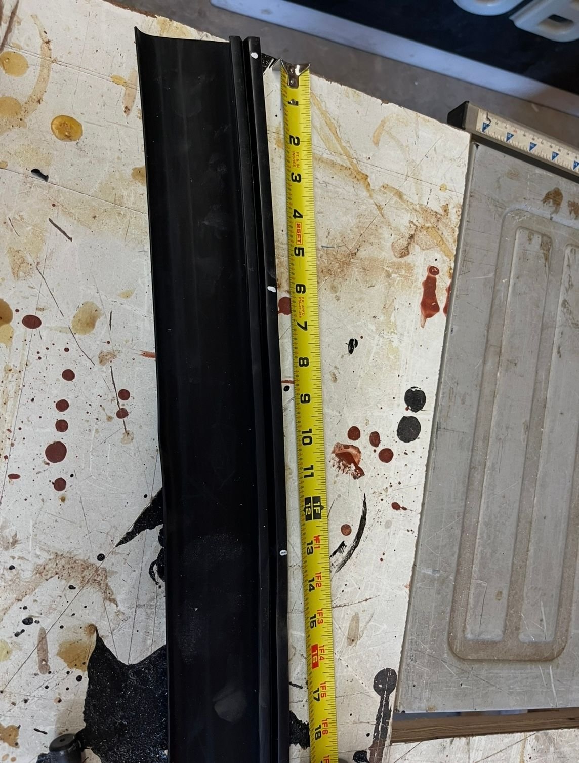

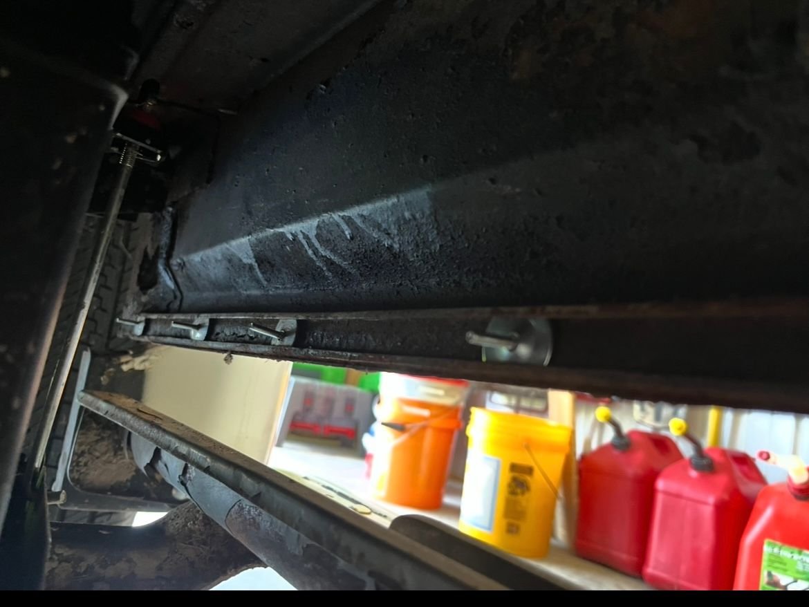

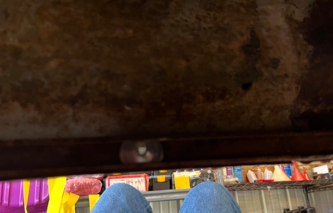

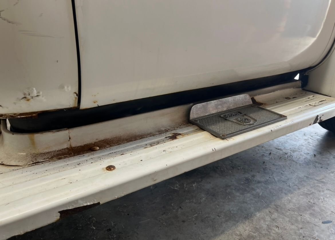

I wanted to install the cab seals for a while but my tracks under the cab are trash. So I took some washers, bent them to take a bolt, cut them to size, and used them in the tracks to hold the seals. At some point I will get the tracks ch aged when I finally get her into paint and body.

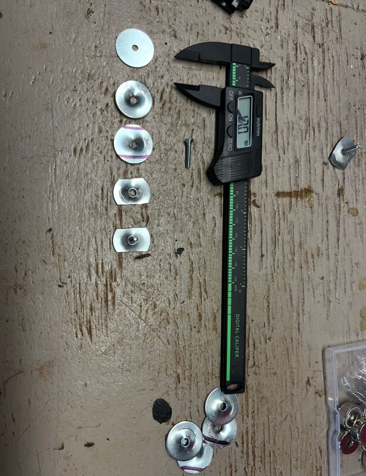

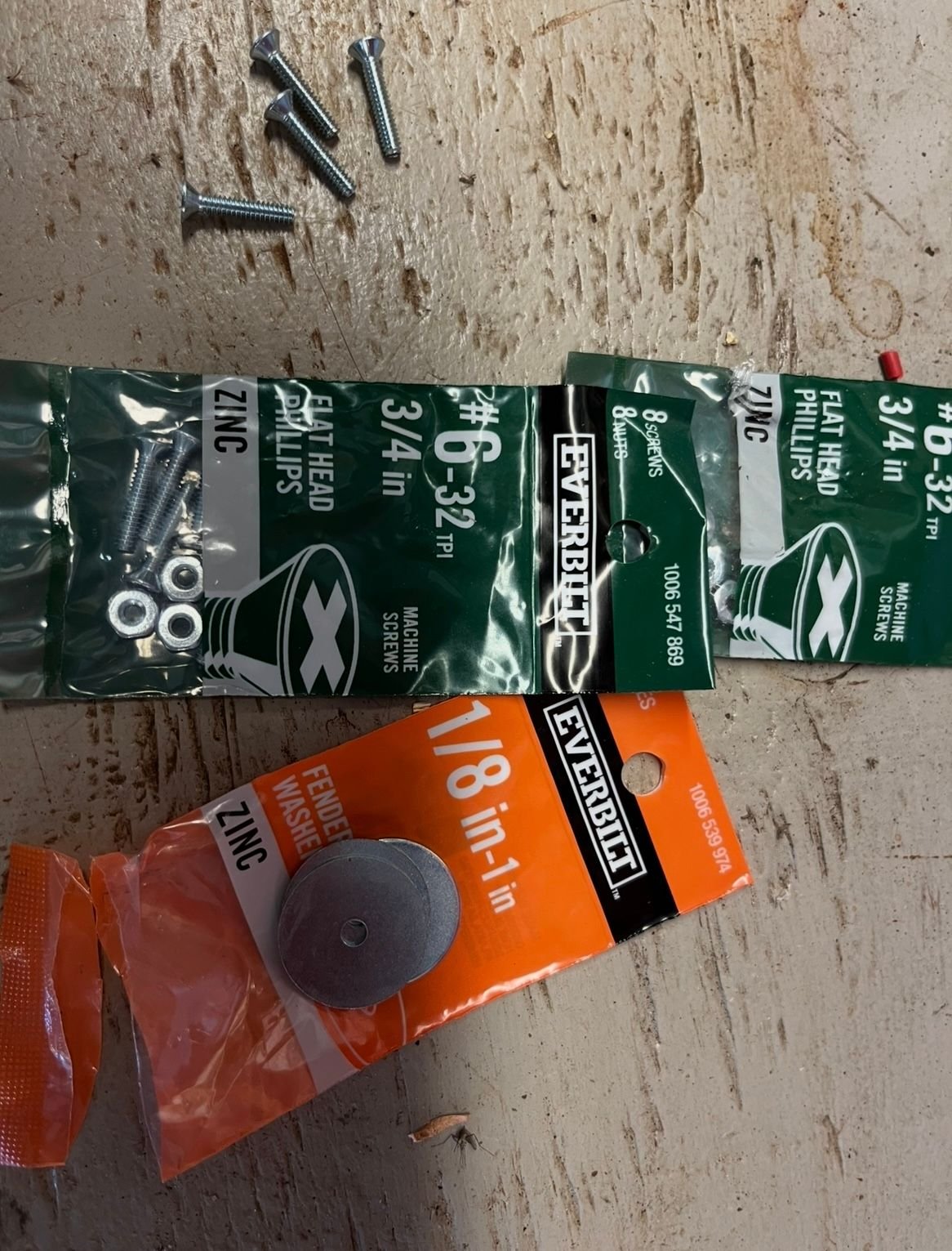

The zink bolts and washers. #6 3-4 bolts and 1/8 flat washers. Could have worked with 1” bolts.

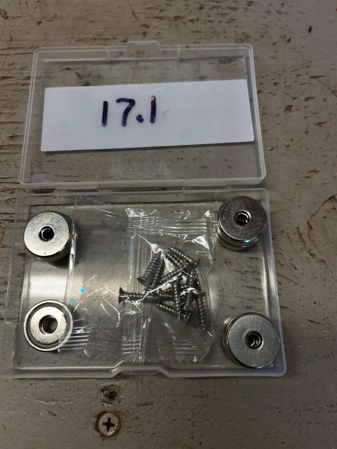

Used strong magnets for the corners

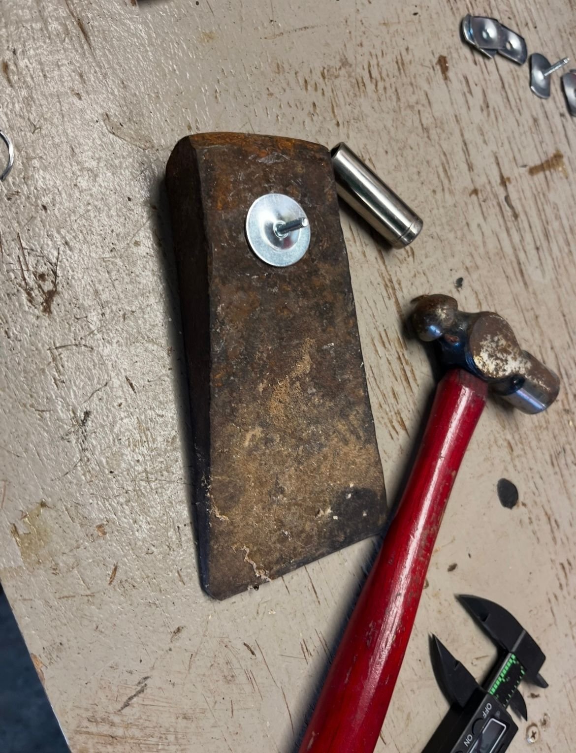

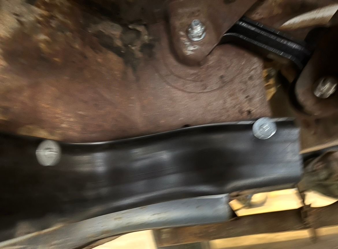

I put the bolt in the washer and used a deep socket to impregnate the washer to keep the same thickness
Start to finish. I crazed glued the bolts to the washers to make it easier to tighten them.
Only made one to check my clearances and if they would go down the track.
They fit perfectly
They fit perfectly

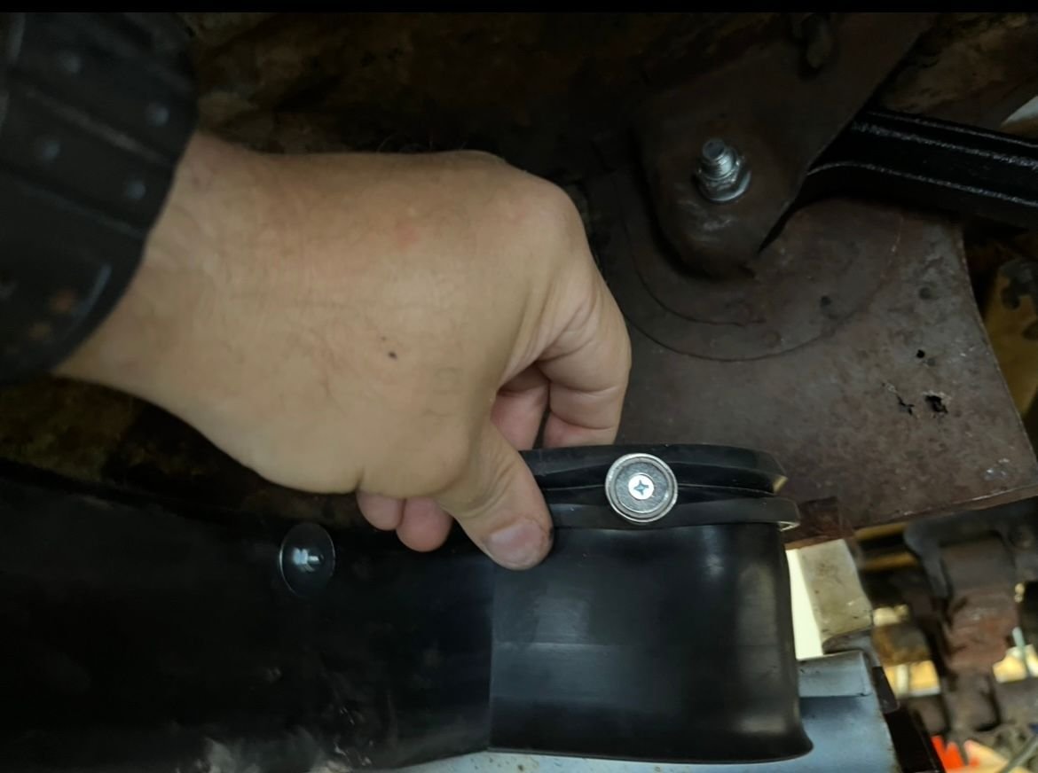

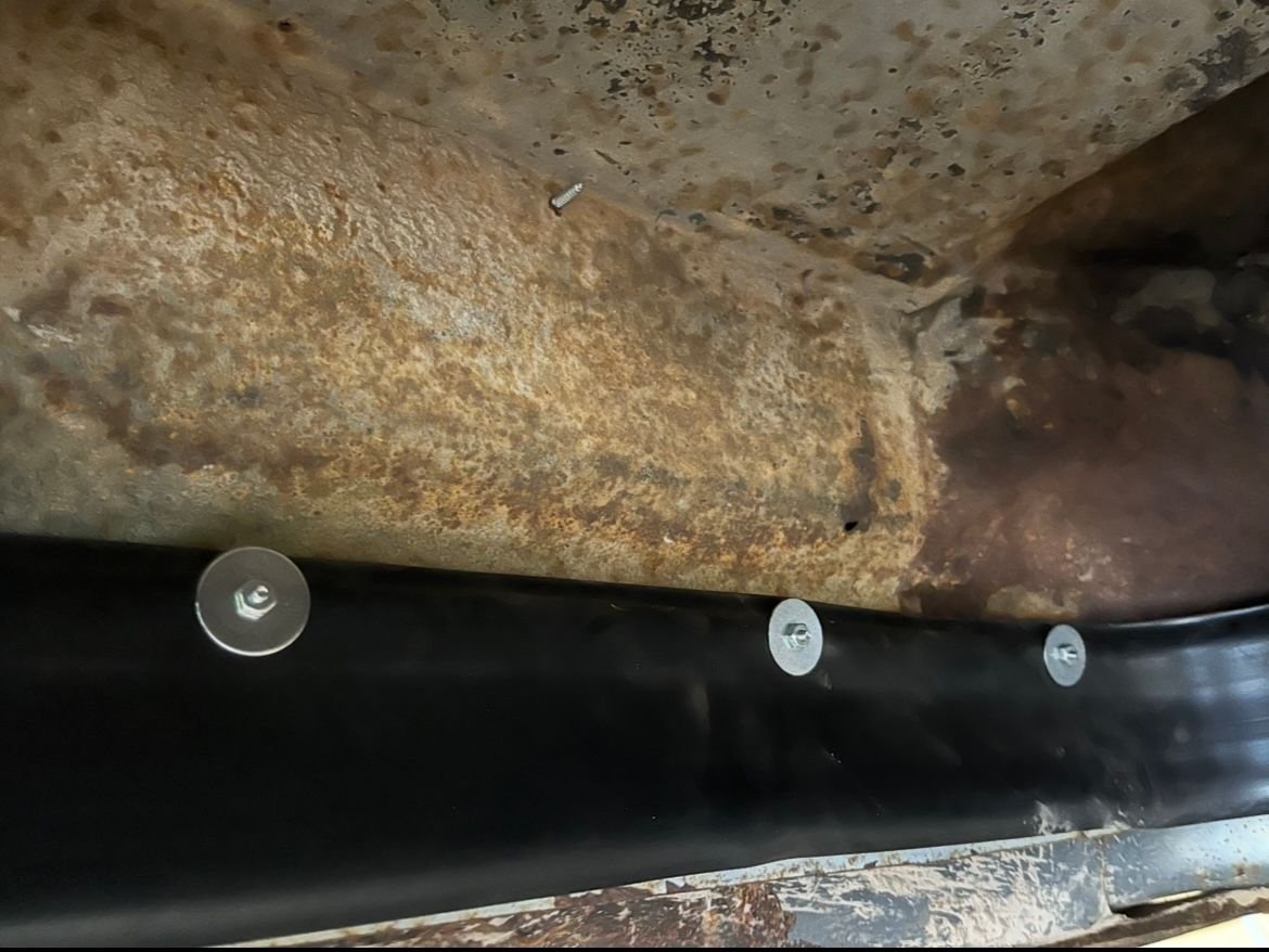

Marked the hokes about every 6 inches or so
Used a leather punch to make the hokes for the bolts
Used the magnets on the corners
Corners, I did add a second magnet
Fits great
Fits great

I may have over thought / designed it. The tracks on the ends were so beaten up I used a few tools to get them open again. On end is starting to peal back and some spots were rotten away. I read where people use glue but I think mechanical connections are the best.
