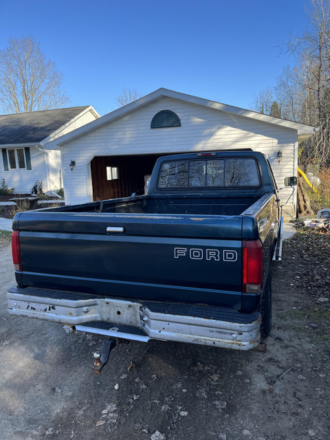

From what I know, there are 2 types of tailgates offered for these trucks. The one with a panel and one without. Are these both the exact shape if panel is removed? I want to add the panel to a "non panel" model by drilling holes in the appropriate areas. is this possible?

is it? I put the panel over a tailagte and it was a perfect fit minus the holes.

Pulled my panel for protection.
Used stainless screws, washers & acorn nuts to fill holes.
Coated bottom washer with RTV, pressed to glass, let dry & trimmed to seal.
Plane panel is the same, just not drilled.
NOT green, just a reflection.

Would you explain what that means? The shape/ stamping of the tailgate is the same on ‘92-96 trucks that have the decal. The previous generation had the FORD stamped in the sheet metal under the stainless panel.

I think he meant to say everything is the same except the holes needed to mount the panel.
