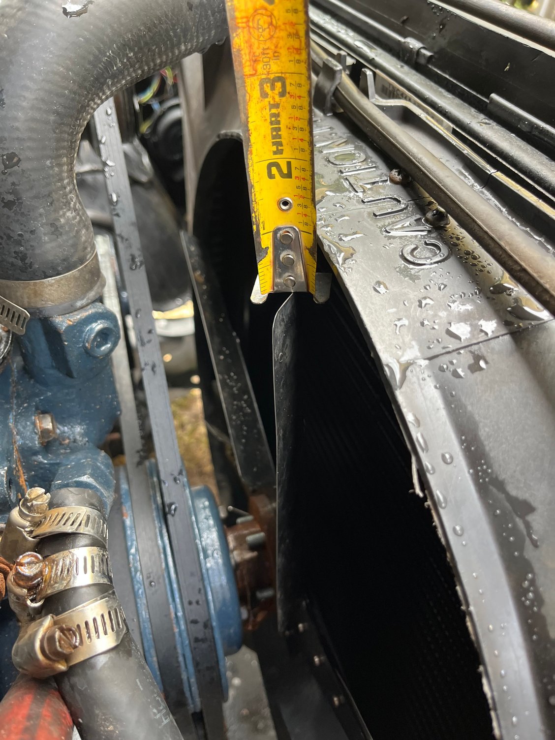

Now on yours I see the fan to radiator shroud, you have a shroud right? may be a problem.
Fan blades need to be half way in the shroud opening. So if the fan blade is 4" then 2" has to be in the shroud and 2" out.
If too far in the fan pushes air into the back side of the shroud and not out. If it is too far out it will not pull air thru the shroud but from outside of the shroud.
Also the blades should be as close to the shroud with out hitting but the rule is about 1" so the motor can move with out the fan hitting the shroud.

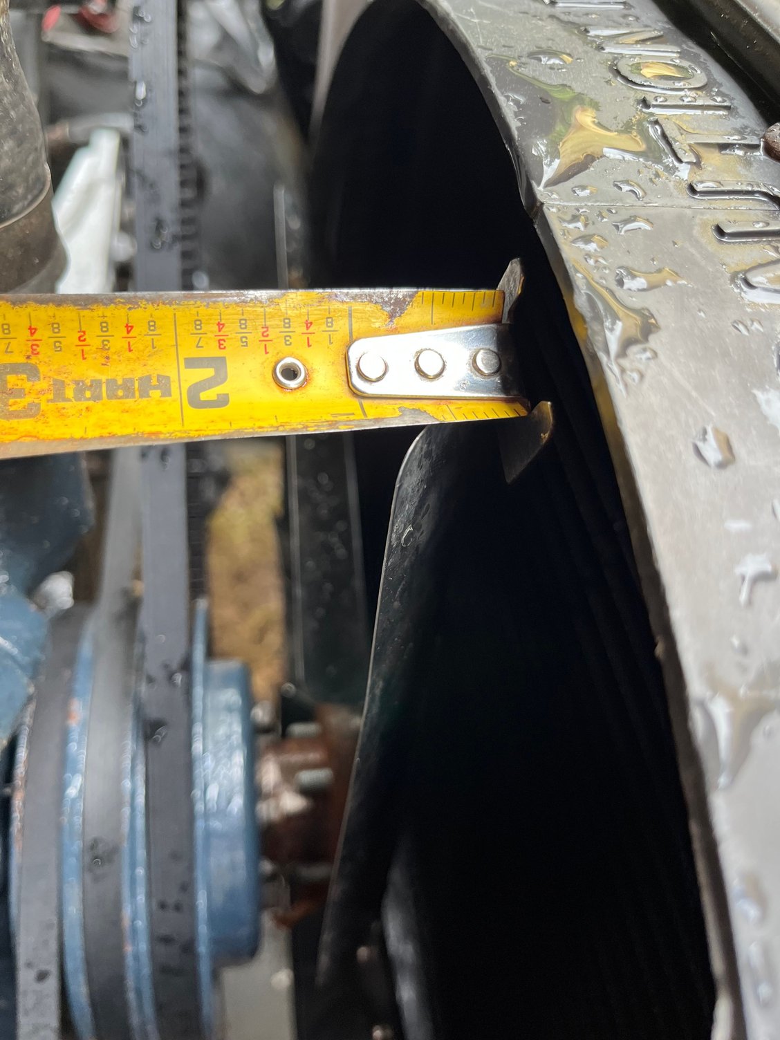

I have ordered a new clutch for the original fan. Im leaning towards condemning this set up . It clearly is not working. As for the how high is to high question the first time I noticed it around 250’ after that i shut it down and kept my test runs short and monitored, shutting down around 220. I pushed the timing up to around 12’ btdc, filled with cap open, overflowing a time or two. The radiator itself is new now. And i have a fan staged in front of the truck to help keep it cool while testing until the clutch arrives. I am not defeated, i have just learned 1 more thing that does not work!

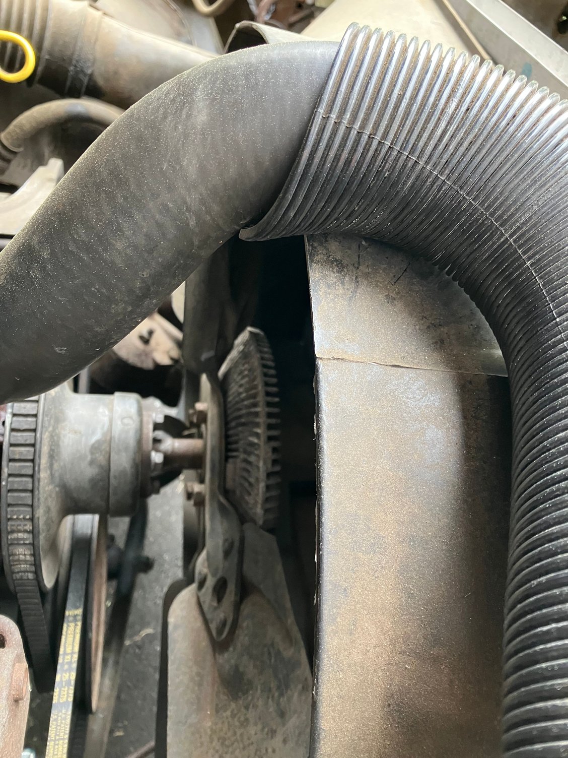

Can someone with a 6 cylinder show you, their fan and shroud ?
Mine's a 302, so the pictures may not help.
FWIW, notice how big my blades are.

Okay, gotta ask. What's with the 3 hose clamps? Was that just a convenient spot to keep 2 spares?
The fit between the fan and shroud doesn't look too bad at all. I wonder if the flex blades are flattening out and reducing the amount of airflow.
Do you have an infrared temperature gun? If not, we'll wait while you zip out to get one.
Back so soon? Great. With the engine warm, measure the temperature at the radiator inlet and outlet. In good working order, the outlet should be at least 30F cooler. This tells us the radiator is doing its job and transferring heat to the passing airflow. If less than thst, there are several possibilities. The most likely is inadequate airflow. Another possibility is scale buildup inside the radiator, but that's not going to be an issue if new. Yet another possibility is loose crud restricting the coolant flow at the inlet tank. Once again not likely with a new radiator, unless some crud in the heater broke loose.
To test the airflow, hold a rag or sheet of paper in front of the grill. With the engine at idle, the rag or paper should be held tightly.
i had several methods to check the temp. The delta was closer to 15 last time i checked. The radiator is new and the block is a fresh rebuild. The paper test would stay but loosly not tight at all.
the 3 hose clamps were a quick fix for a slow leak that still needs a proper fix. While trying to break in the cam.

Originally Posted by Denzil B
The delta was closer to 15 last time i checked…
The paper test would stay but loosly not tight at all…
Ooh, this is getting exciting! That temperature drop looks to be insufficient. And the result of the paper test doesn’t sound right, either. If indeed you’ve got low airflow through the radiator core, that would ‘splain a lot.
Keep us posted what you find after swapping back to the original fan setup. I would suggest resisting the temptation to make a whole bunch of changes all at once. For example, say you also rework the shroud at the same time but unknowingly that makes it worse. Meanwhile, you’d have no idea if replacing the fan helped or not.
