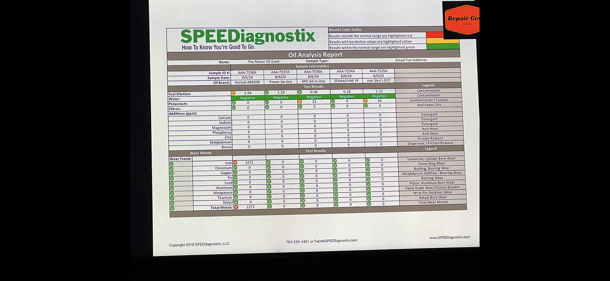

Thanks for sharing your report. Since you brought up Hot Shots, we now know via an independent study performed by Southwest Research Institue that Hot Shots doesn't perform so well with the SCAR tests which directly contradicts their own marketing.

@FishOnOne I know you don't like the Hot Shots and it is not my intention to argue that. However, the video that Project Farm put out several months ago shows that the Hot Shots and Archoil was neck and neck with wear scar, and Archoil only minutely beat it out. I know that it will be said that his testing wasn't as precise as the testing done by Southwest though. And it has been a while since I have seen the video that presented the data from Southwest, but if I remember correctly, it put OptiLube at the top.

Just for kicks I used the same dosage of EDT that Archoil uses, and my MPG went up 2 MPG. I only did it to use up what was left in the bottle, but its sitting at 18.2 where it usually sits around 16.5. I noticed a bit more Oomph too, must be the cetane boost.
As far as regens, until I can turn mine off, it makes zero difference which one I use, regens are the same. Soot levels are identical between Archoil and EDT. Once I burn through this tank, the next will get no additive, then the following will get the next batch of Archoil for my summer tests.
Also EDT claims exactly what the tests shows on scar wear.
EDT provides maximum protection for fuel systems and their components, especially fuel injectors and fuel pumps. It is infused with our LX4 Lubricity Extreme to improve diesel fuel lubricity by up to 26%*, reducing the wear scar by up to 159 microns* ensuring diesel fuel passes the lubrication recommendations set by the Engine Manufacturer’s Association (EMA) of a wear scar maximum of 460 microns.
That wear test done, 72276, verified EDT's claims with a 450 wear scar. Keep in mind this is based on the dosage. Double, or triple the dosage and that wear scar will get smaller. 1 ounce per 25 gallons. I use 2 ounces on a 48 gallon tank, this last fill I put in 5 ounces to empty the bottle.
Archoil shows a much better wear pattern, but then again it is also dosed at 1 ounce per 10 gallons. It's a much higher dosage, so just based on that, should provide better lubricity.
