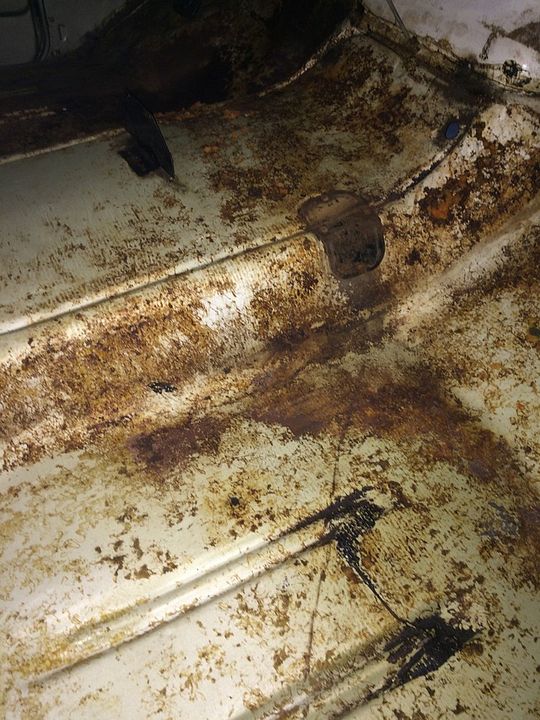

Folks, I'd like to have my transmission cover painted along with a bunch of other parts.
Question: The round opening is bent upwards at two locations; is this normal from factory? Or is it due to someone trying to get more clearance with the shifter?
I'm reluctant to flatten it out at this stage. I'm doing a cab-off restoration currently.
This is on a 1965 F100 with T18 transmission. I understand these trucks settle over the years due to compression of the cab mounts.

Should this opening be flat.  I fairly certain it's original to the truck

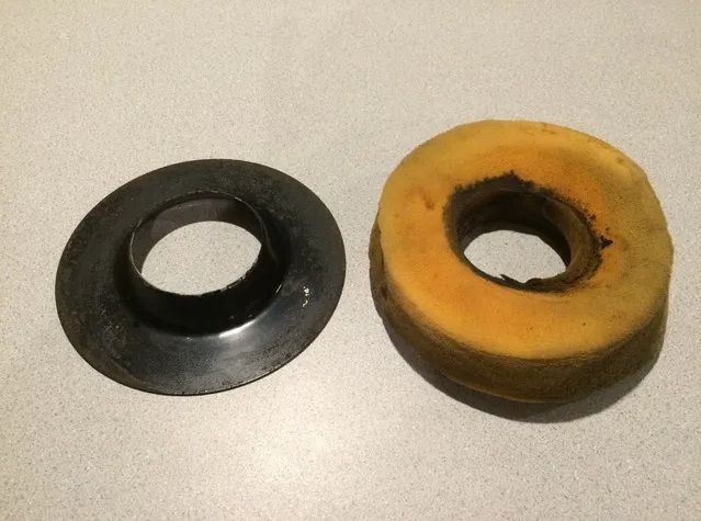

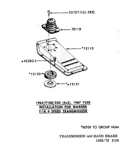

I'm not there but in the picture you posted the center hole looks like it isn't round as well as not flat. Might be an illusion. And no screw holes for the boot that I can see. The MPC shows what seems to be a flat cover - all I've taken apart personally have all been flat - as well as holes for the boot. Do you have the other parts there shown in the drawing? The 12130 and 12131? Those are parts that make up the "weather cover" and being the 12131 is typically flat around the circumference that I've seen it makes sense that the floor be flat in the same location.

Thank you for taking the time to educate me. The hole is indeed a circle. It does not appear to be a modification to an automatic cover, however, the lack of bolt holes raises suspicions. Perhaps a circle cutter was used. I do have a used rubber shift boot that came with some parts I got awhile ago. Looks like I'll be drilling holes should I decide to use it here. As for the donuts, they look simple enough to kludge something functional. I'm going to flatten it. It's the OCD in me that cares....

Besides the picture I posted before the MPC text portion says it's a 5" diameter hole. The NP435 transmission sometimes used a square hole but I know of exceptions there myself. I guess OCD and 60-year-old trucks may not be a good combination. Enough to drive a fella nuts...
