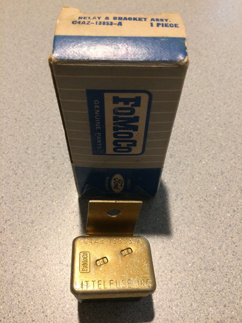

LITTLEFUSE is the relay for the horn(s). Sort of an automated switch.
C4AZ-13853-A - RELAY and BRACKET ASSY. HORN - #C4AB-13853-A

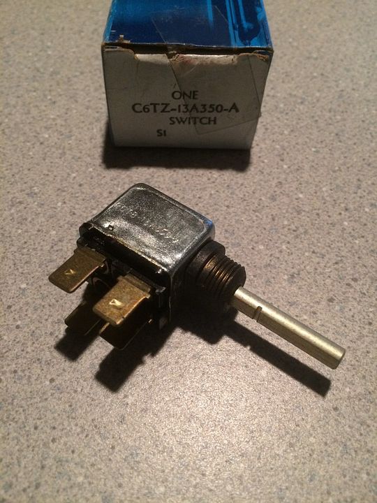

The other one under dash looks like something that came apart and they left the remnant plugged in. Might be the emergency flasher switch. The below part but only the black base where it plugs in possibly. Otherwise, I'd need more context of where in the harness that is.
