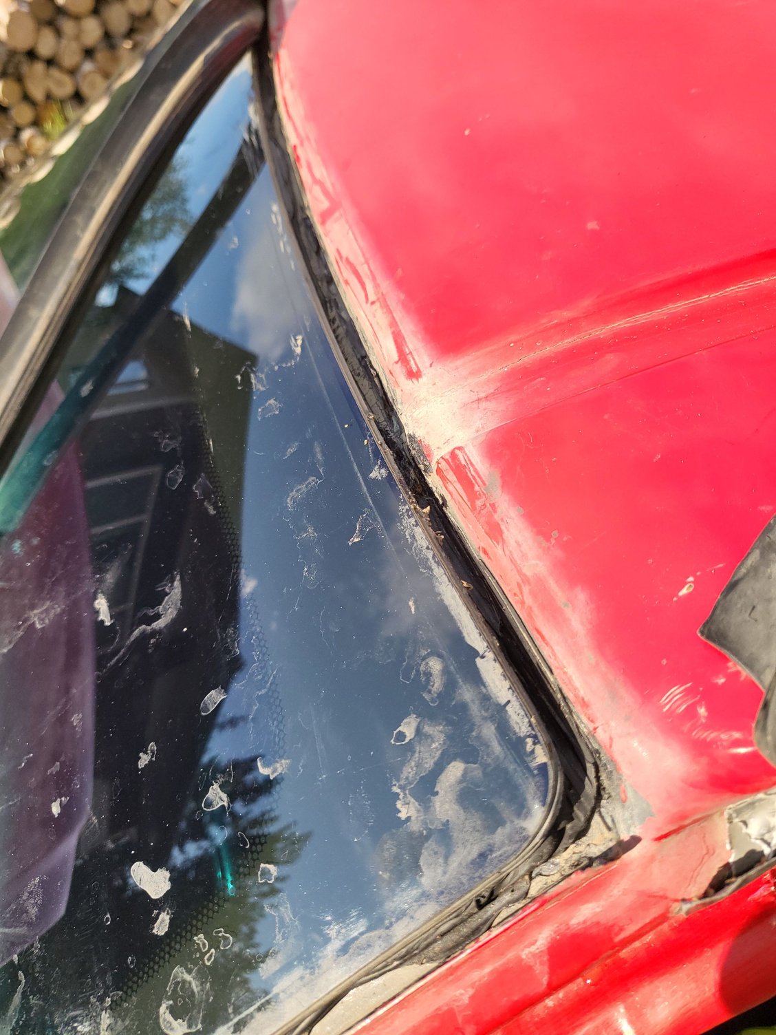

Fresh Update. Had to use garden hose but finally saw a 💧 at bottom of the pillar trim.
windshield appears to leak at top. Some of corner and about 8 inches toward center.
Not affording a windshield so I 🤷 did what I could do.
pulled the windshield side molding and near half the upper trim.
Cleaned out the grooves. And unfortunately only had some kinda extreme gorilla construction adhesive..
It laughed at my cheapo caulking gun
​​so as necessity dictates i got creative.
Used my ball joint press.
never made such questionable repairs.
but if it works and gets me to work without cutting out.
it may get a new windshield for Christmas 😀
Ball joint press caulking gun.

Why do you need a new windshield? Is the one you have cracked? You can't remove it without breaking it?
Old Jun 13, 2025 | 05:46 AM
  #38
Oregon Kickstart's Avatar
Oregon Kickstart
Joined: Apr 2025
Posts: 89
Likes: 32
From: Western Oregon
this year span of pickups notoriously leak at the windshield, which in turn corrodes the GEM module, which this post is about....
