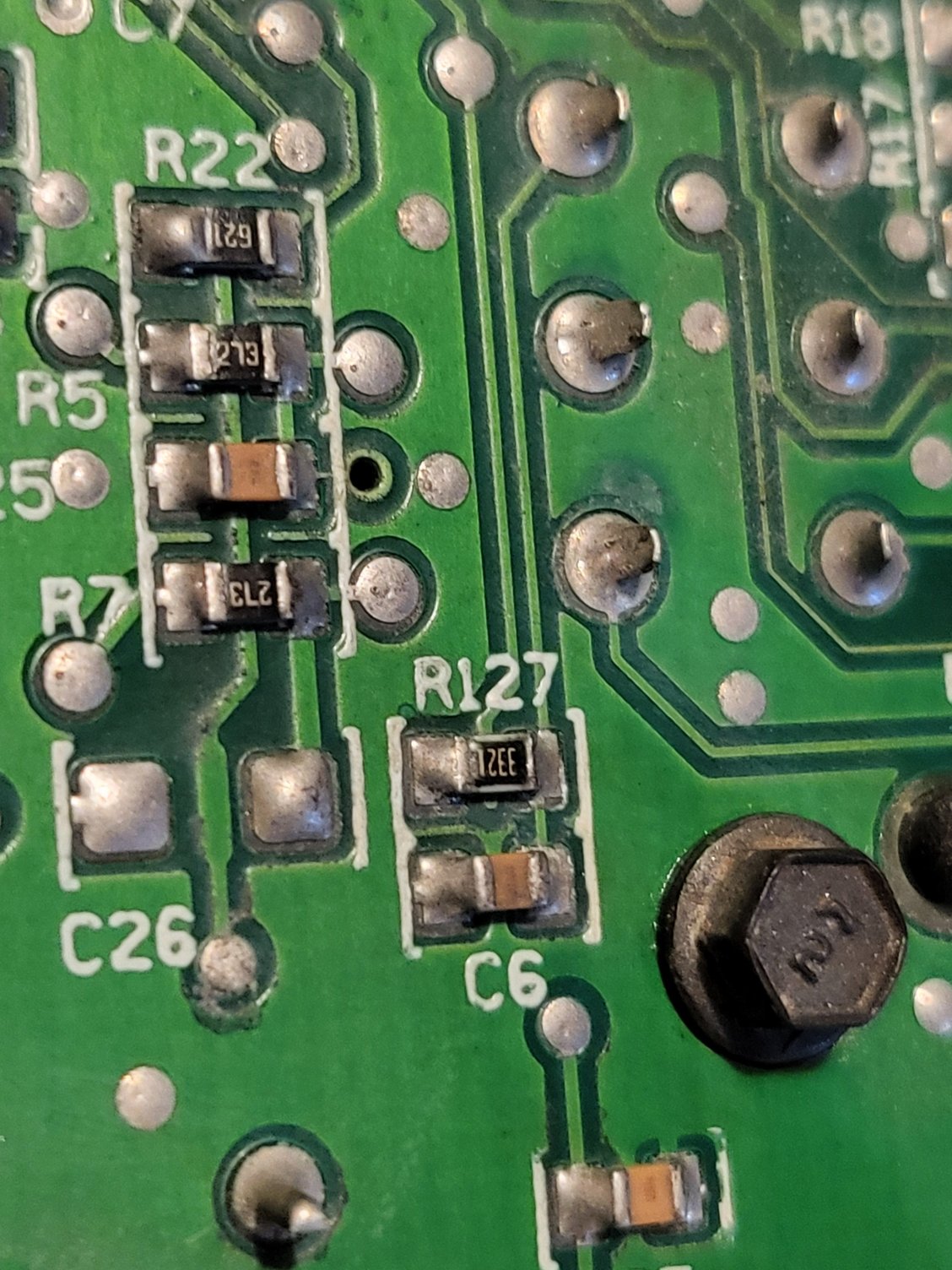

im stuck at needing a replacement fusebox or parts from another. Some metal traces are toast

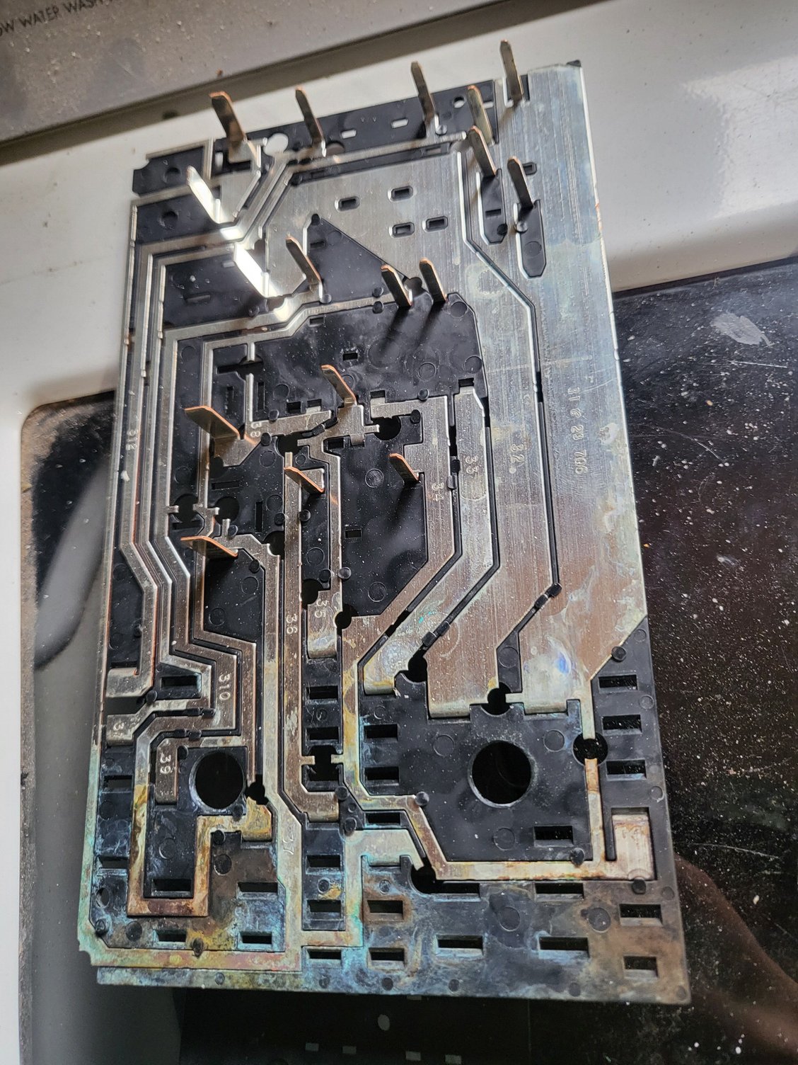

Trying the vinegar soak for the metal strips.
baking soda n water after. Got some bad parts
see if I can post pictures in understandable order

Before.
Aftermath of vinegar soak, n baking soda did after.
The top left on. Appeared black. Like arced enough to melt it ssome.. was doubtful of vinegar. But works.

My apologies for the numerous repost.
was supposed to be different pictures.
yes my fusebox worst ive seen.
. First layer 1 metal strip corroded into 2 pieces.
connects between 5amp gem fuse#15. And 2 connections on gem and 1 wire to bolt on plug.
Wonder if this causing engine cutout.
not surprised 😒 the issues. Water pours in like I have the doors open. Going to pull the wipers and the cowl cover and hope I can see 👀 where this river is flowing in.

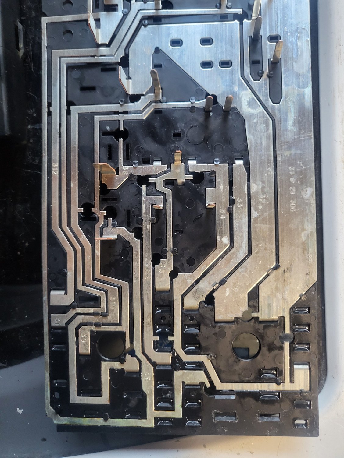

After vinegar soak. Still looks bad. But hundreds better than before

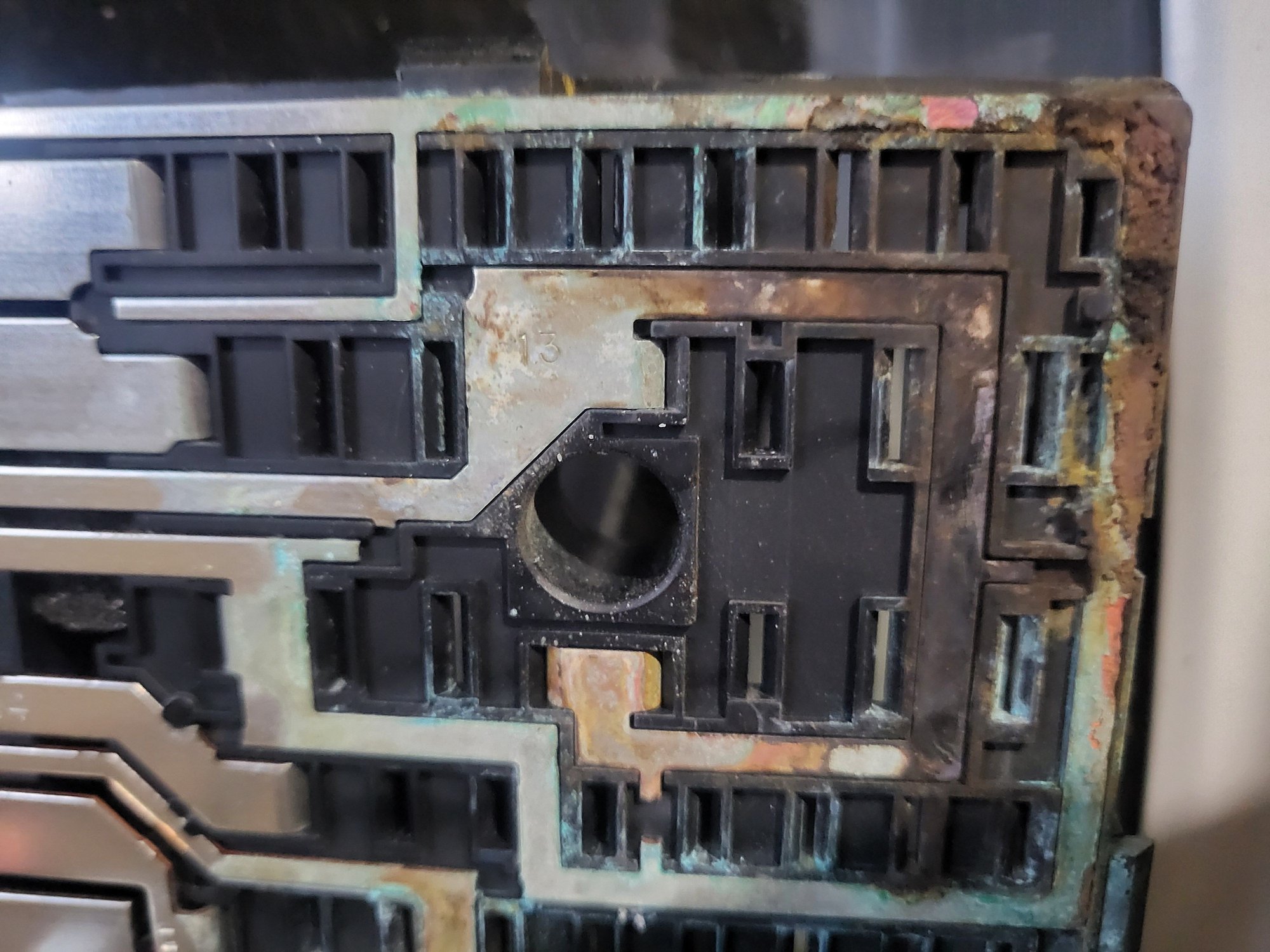

Basically every layer was pretty corroded.
vinegar soak seemed useless till I let it sit a while.
Another layer before
And after vinegar. Im a have to say this a legit
And after vinegar. Im a have to say this a legit "hack" i did follow with baking soda and water to neutralize any acidity
If you do pull pusebox layers apart.
I would take picture of fuse layout and remove fuses and holders ect. I did first time. This time. I left them in place.
easier but seemed to pull way more of them metal strips off each layer than if I had removed fuses and holders

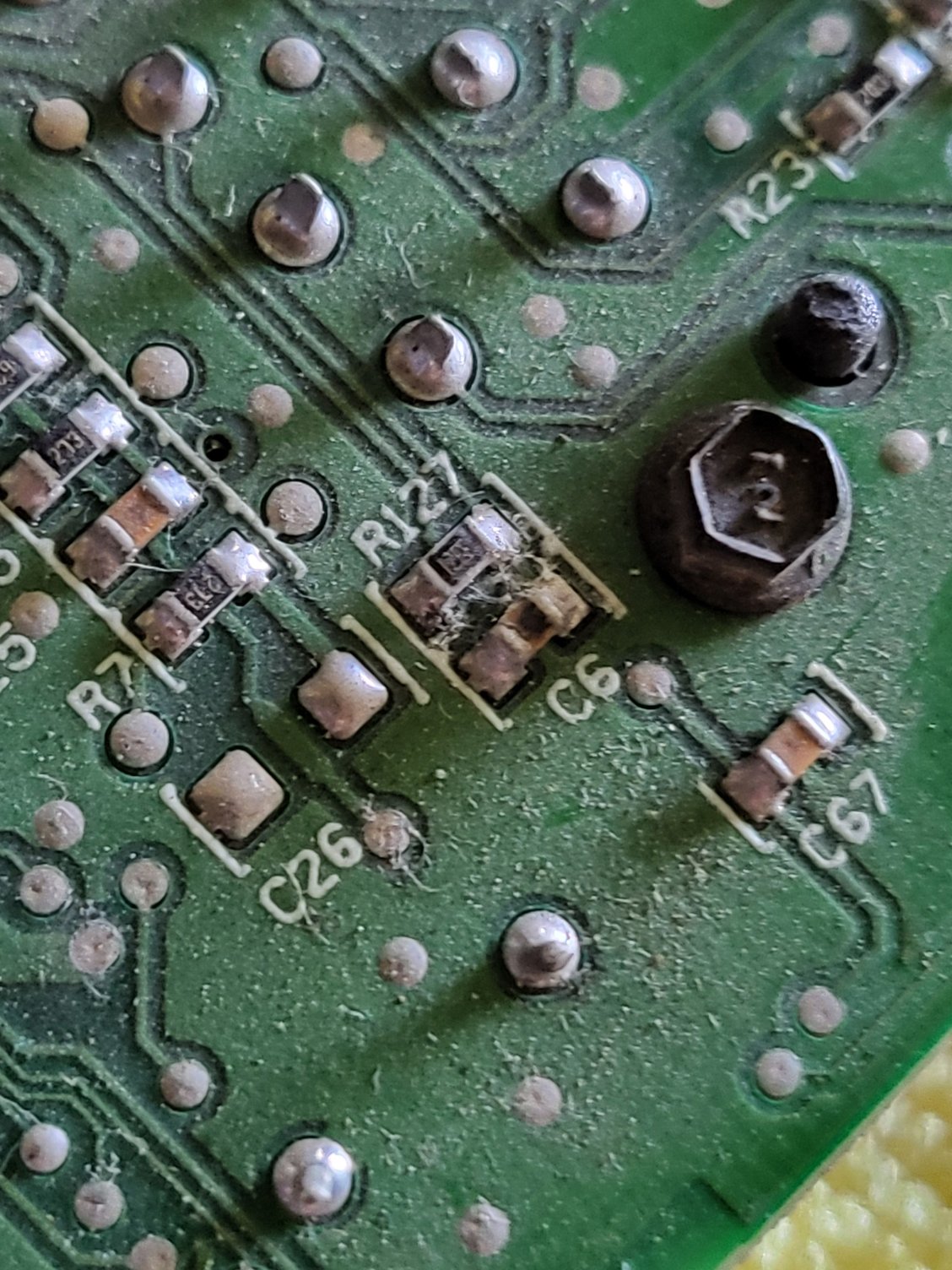

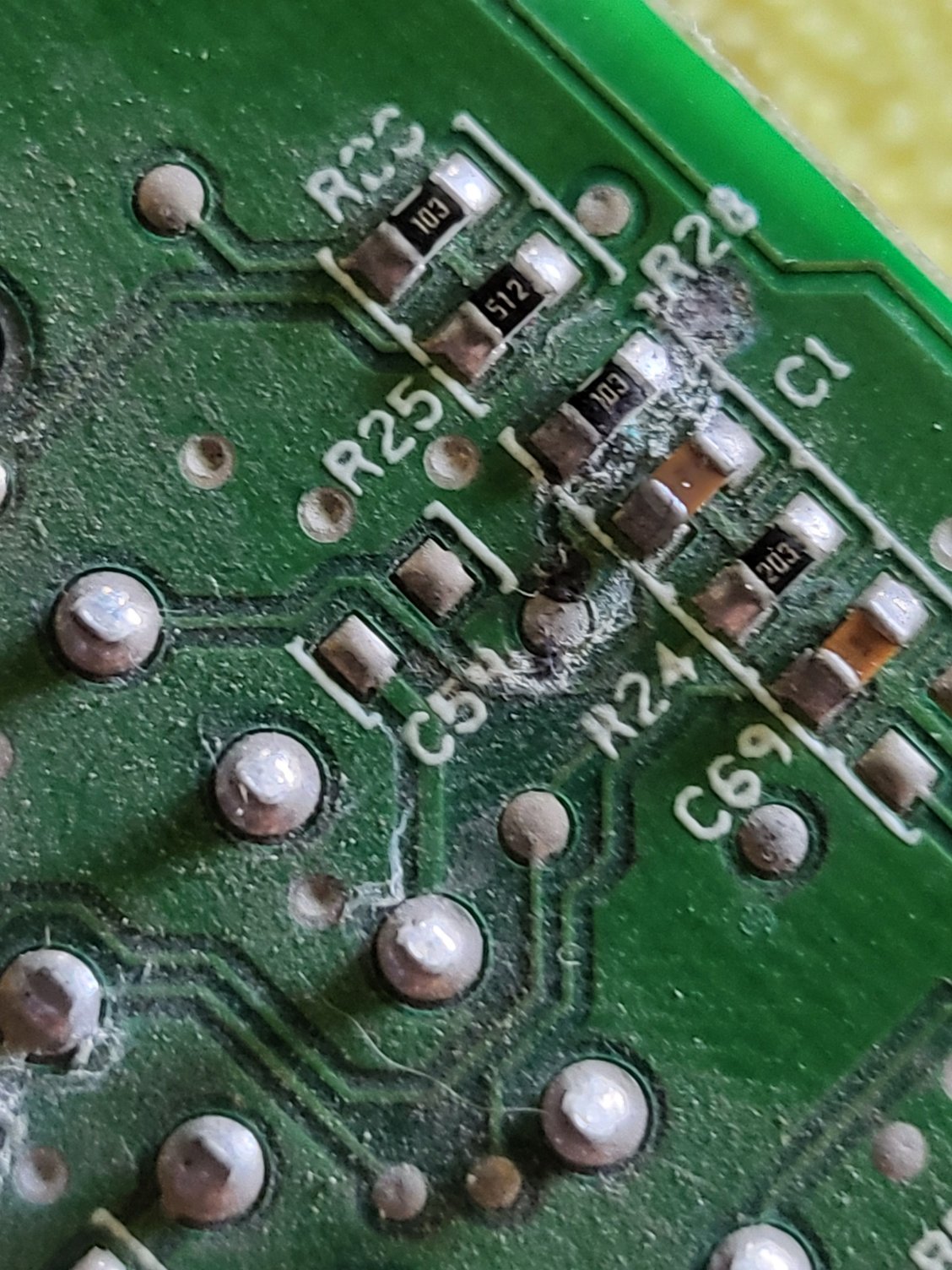

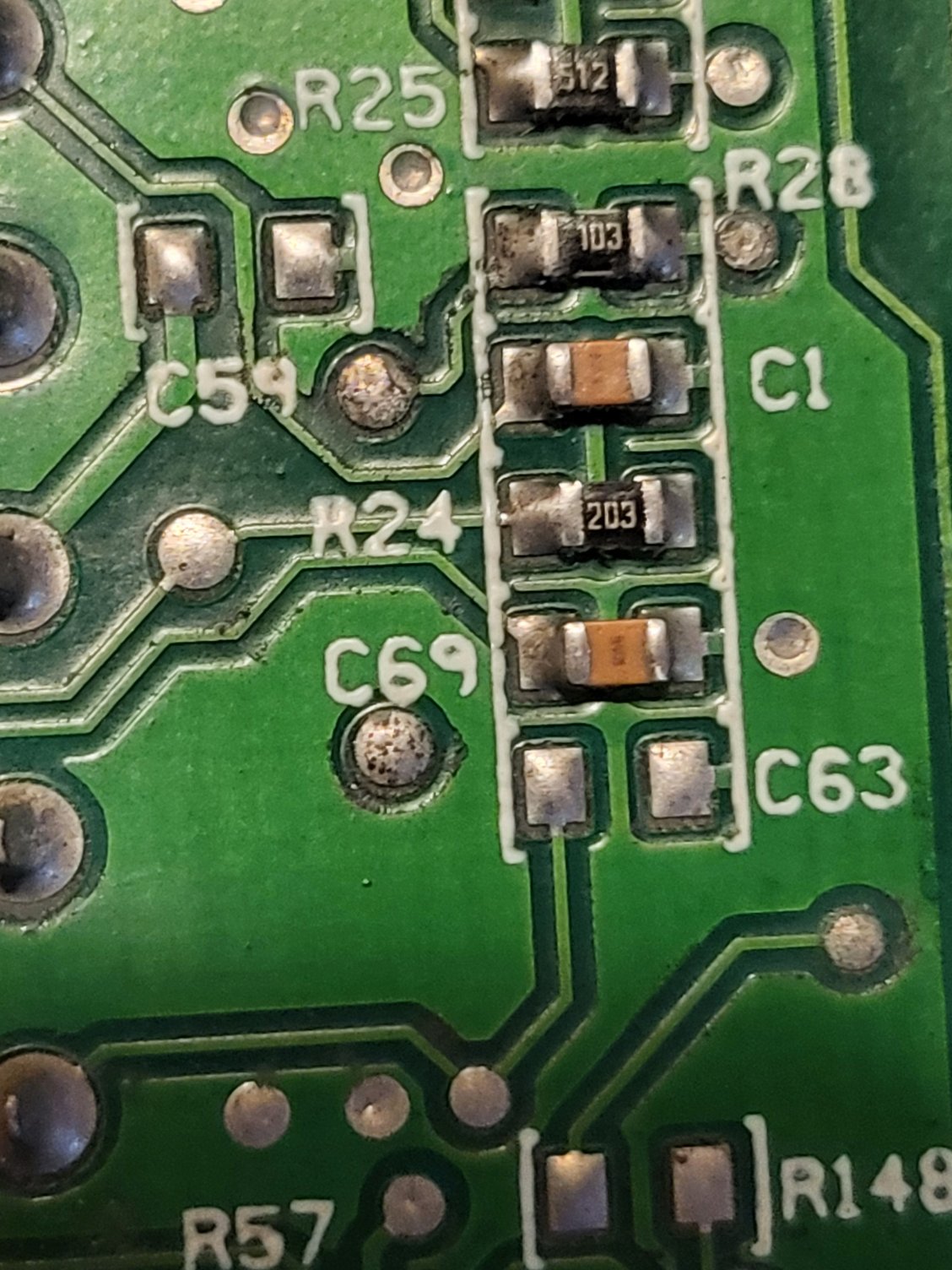

Thought the replacement gem wouldn't be too rough.
only saw bits of corrosion in about 4 spots.
thought a l Iittle cleaning and good.
took pictures. Dont like the black look of things.

Looks much better after some isopropyl alcohol and scrubbing. Going together in a minute. Fingers crossed 🤞
