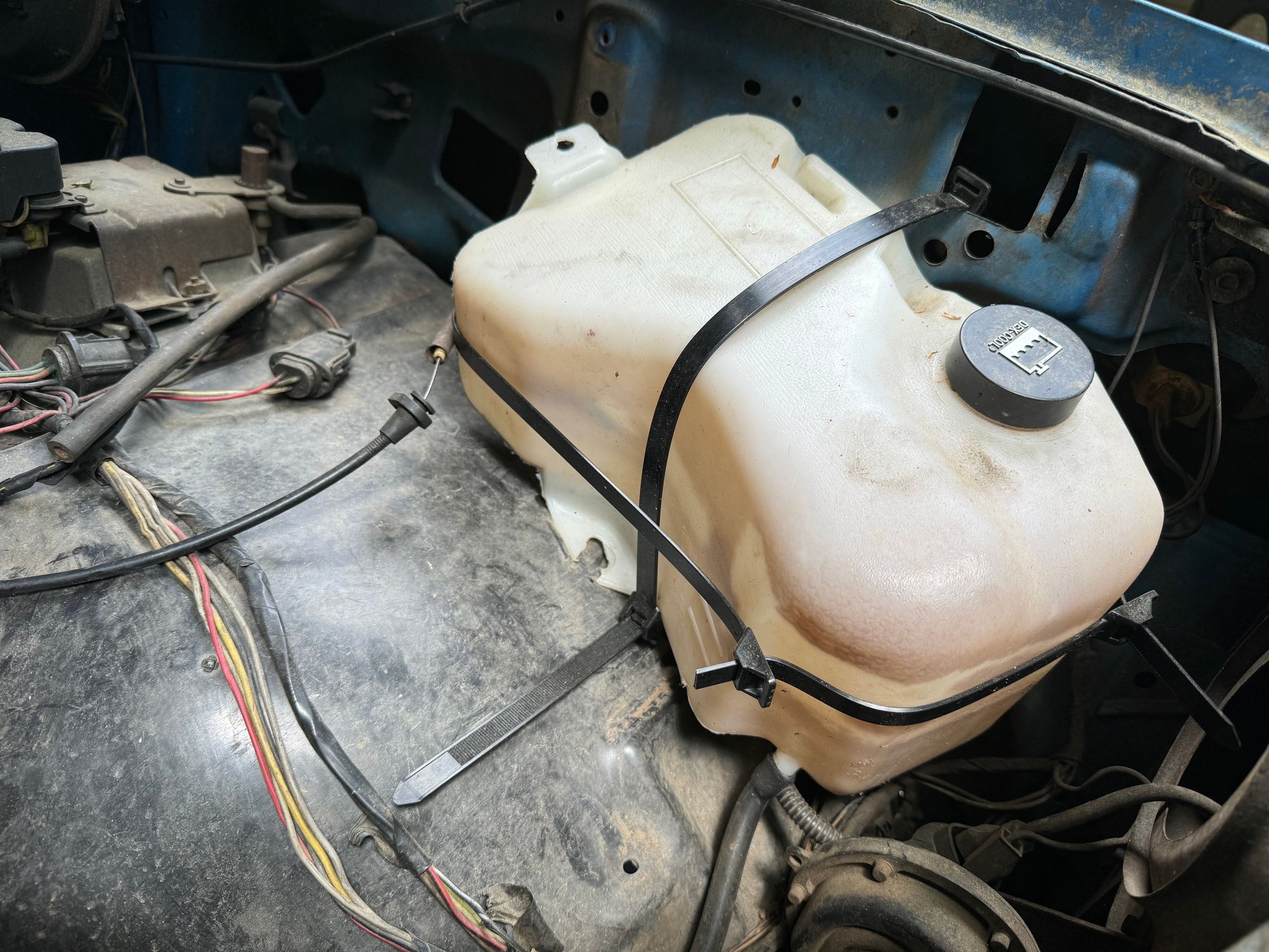

I just did the old zip-tie thing many years ago.

Yes, as long as the hose is near the bottom, it will suck coolant back into the radiator. Even some new cars go onto the top.
