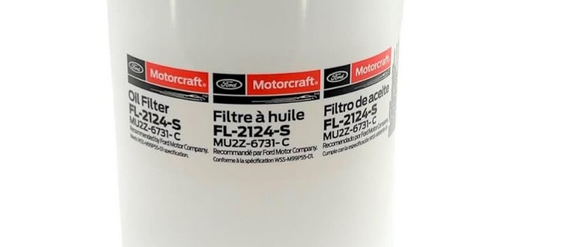

The easy way to detect Amazon counterfeit is the label.
Not Motorcraft, though quick glance and you might mistake it for one.
Actual OEM Motorcraft filter
This is the one I get, its from the Motorcraft Store on Amazon. This and the fuel filters are the legit ones.
Amazon Amazon
Amazon Amazon
Legally, if this was selling counterfeit, Ford would be all over it and Amazon since it would be trademark infringement.
Amazon Amazon
