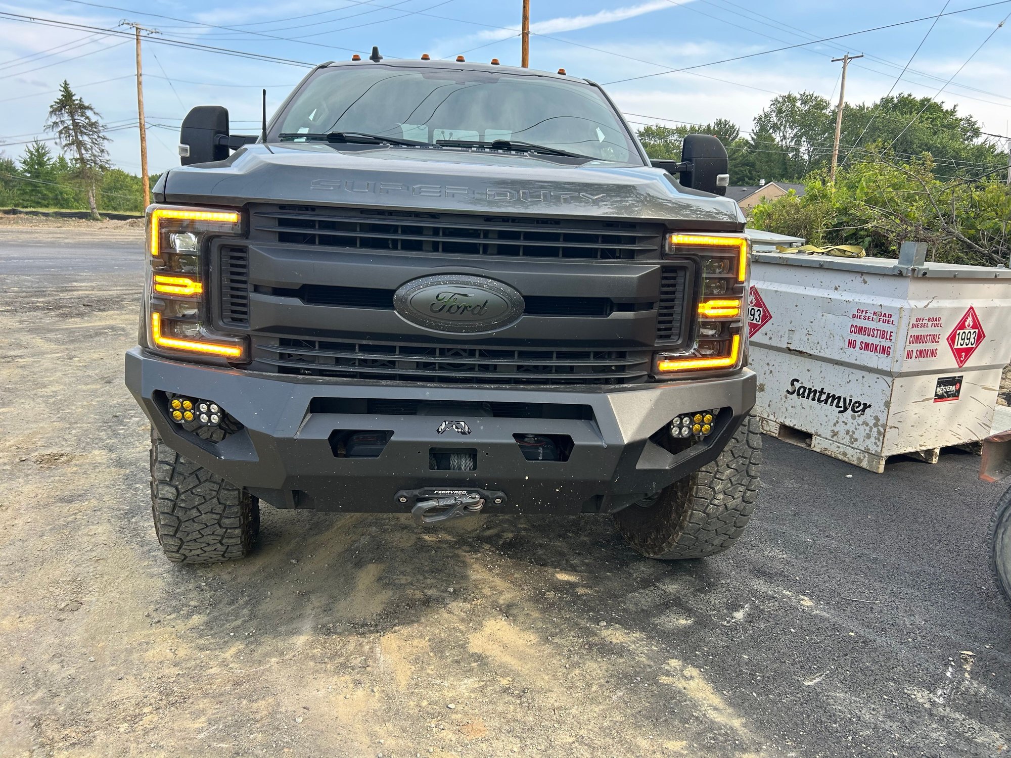

2019 F250 Powerstroke: I just recently installed the XB's on my truck and at first all was good. about a week later I noticed that the outer Halo on the passenger side was off one morning. So I started trouble shooting and could not figure out what was going on. To summarize......With the selector switch is the AUTO position upon starting the truck everything worked as normal. After a few miles down the road the HALO would go off. I could toggle between AUTO and ON and the HALO would come on again. I tried just running the switch in ON position and the same thing would happen. I also noticed one morning parked in front of a business that when I turned on the turn signal it would work, but when I turned it off the HALO would not light back up, so I thought the light must be faulty. I contacted MORIMOTO and their customer service was spot on and set up a replacement. Installed the new replacement and just like the first one it worked for a few days and started doing the same thing mentioned above. So at this point I'm thinking something must be wrong with my wiring harness. Well I contacted MORIMOTO again to maybe help with troubleshooting and they stated that they have never had this issue before and maybe I received another bad light, so without hesitation they sent me second replacement. I installed the 2nd replacement last night and drove the 20 mile commute to the gym pulled in the parking lot and low and behold the damn HALO was out!!!!!.....At this point I do not know what do. I am hoping that this has not been an issue for anyone but if so maybe you can help me out.
FYI....the only deviation I made from the install is that I did not tap the DRL's into the fuse box, I ran them to one on my Upfitter switches so I can control manually and they work fine.
