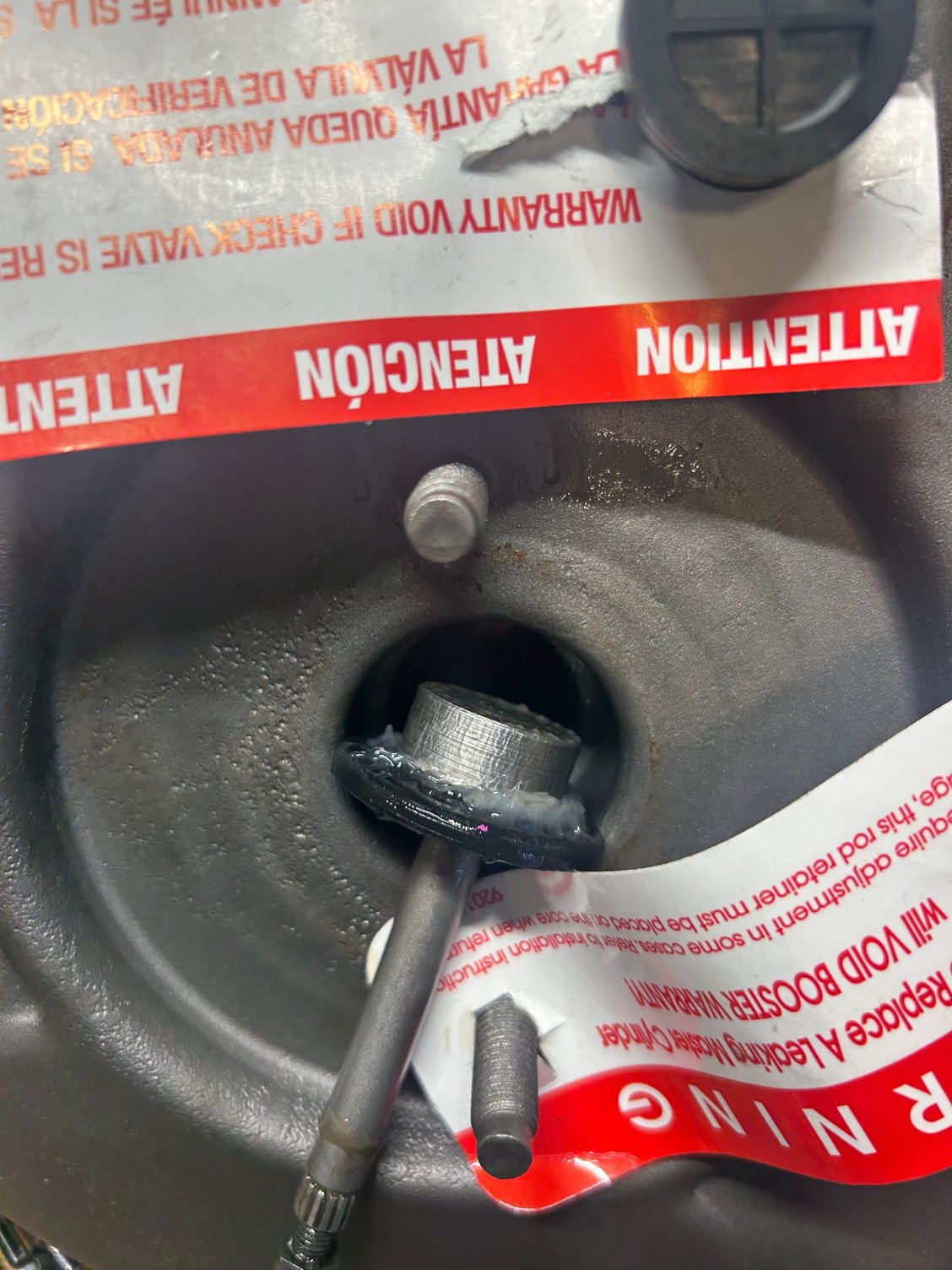

Well. I went to install a new booster. Here’s a picture of what I got out of the box. That is some seriously high-quality.
