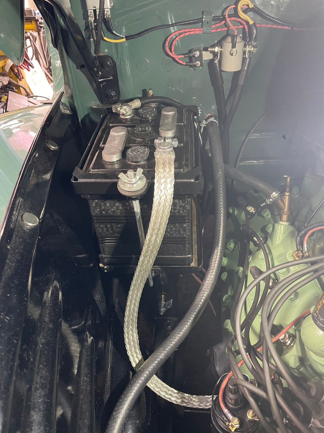

53 to 56 trucks have the battery under the passenger side floorboard. So there is no headroom issue under the hood. And because it is out of sight, looks don't make a difference. And because the hold down goes over the top that shouldn't matter .

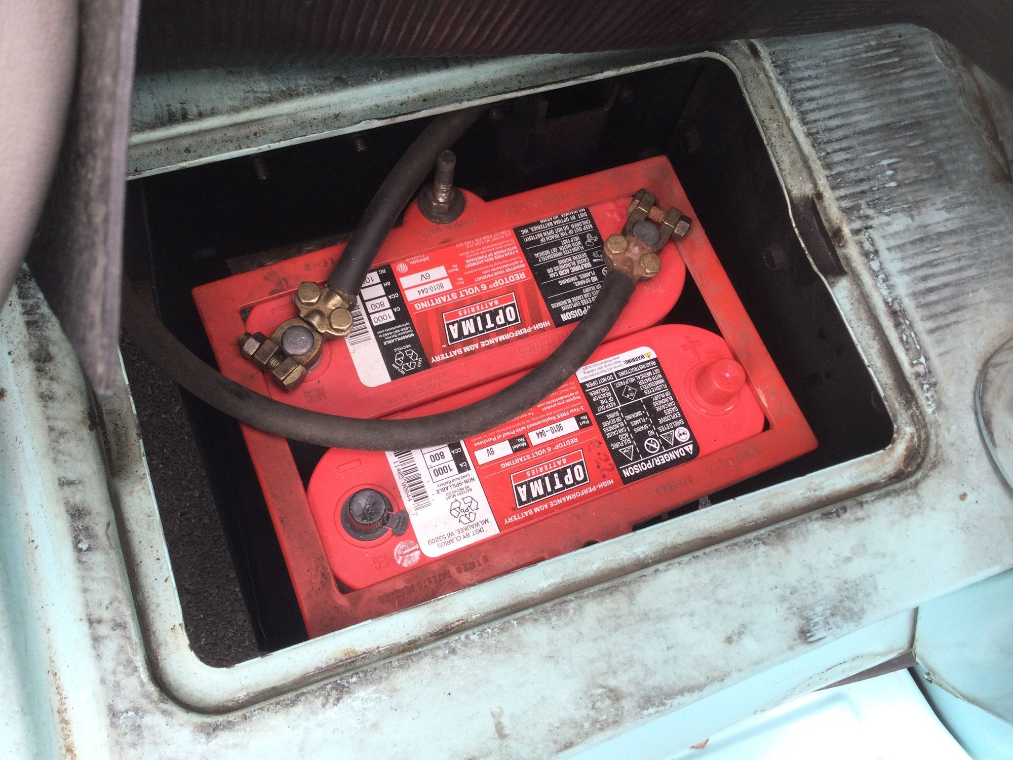

Joe, unless they’ve changed something, they should fit. The one that’s hooked up I think I bought in 2013

Dennis, I like that setup. Having a spare handy is good, but not for the price of them nowadays.

Here's an option for anyone looking for a OEM style battery with an AGM battery inside. Although it's not an Optima brand. Now available retail from
Battery Central Mall dot com 804-861-0165. Wayne Cunningham.
