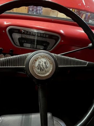

Do you have a picture of the rare "50th Anniversary" Mercury truck steering wheel and horn button..?
It needs restoration loving, but here you go...

Thanks first time I seen one, the button on the 56 I have looks completely plain..and have no idea what it is supposed to look like but I also have an aftermarket wheel and column..

That's a cool horn button. I've never seen one before. But yours will be hard to restore, me thinks.

First, I've got to say that horn button is way cool. I've never seen that before, either. Ironically, the 50th anniversary is for the Ford Motor Company. The Mercury name was introduced in 1939, so only 14 years earlier than the button. Still, that's a very cool piece to have.

Agreed. My wife is a designer / artist. She said she'd take a crack at it. Gotta figure out how to seperate to insert from the plastic cover. And then possibly try to get a new plastic cover.
Would a 53 Ford Jubilee horn button plastic cover fit, if you can get it off....
