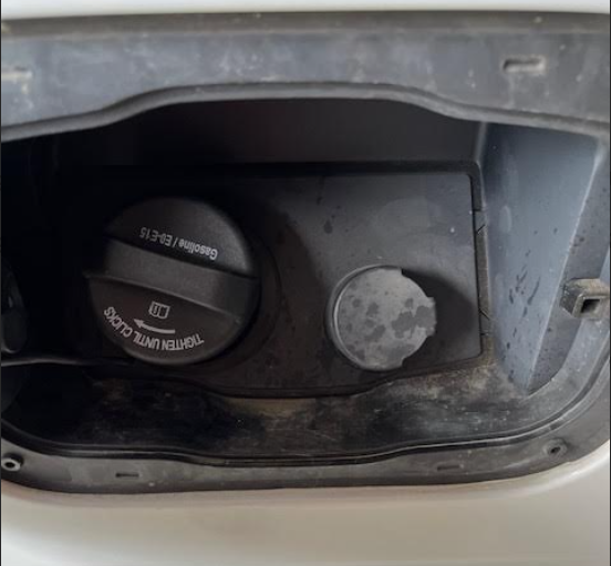

2022 F250 long bed double cab 7.3 Godzilla. I had to see things go to waste. My truck has a filler tube and a tank for DEF. As I read the tank size is close to 8 gallons. I would like to use the tank for some non-potable water. I wonder what would happen and what code would be thrown if I modified the tank to hold water.

Seriously it has a def tank? They did away with the $2 underhood light but are putting def tanks on gassers?

How did a gas truck end up with a DEF tank???
And, if it is a gas truck, how would it throw a code, it couldn't be hooked to anything.
Are you thinking you would use the DEF pump in the tank for pumping water?
It is really made to be an injection type pump, to inject DEF into the exhaust pipe, not a very high volume pump.

I believe that is a vent for the EVAP system

BS. No way they are outfitting gas trucks with diesel parts, especially parts like a tank. That isn't a filler tube for DEF, and that isn't a DEF cap. The DEF cap is blue for one. That tube you show is too small and it is too pliable and flattened in places. The filler hose to my DEF tank is more like a large heater hose in construction. And there are hundreds of posts on this forum alone with people trying to add Platinum accessories to their lower trim trucks, only to find the wiring harness doesn't have the required connectors for those devices. That line worker is full of it. There are likely some connectors found on every harness, regardless of trim level, but there is ZERO chance a Platinum harness is being installed in every XL truck. There may be a decision made to install one due to a temporary parts outage and they need to keep the line moving, but otherwise an XL truck gets an XL harness.

My FIL had a '22 with the 7.3 gas. It did NOT have a DEF tank, and the fuel tank part number for a gas truck is different than that for a diesel I'm pretty sure. That black cap is a vent cap, and that tube is a vent tube for emissions.
Your 'friend' who worked for Ford may not have known it, but he lied to you. He believed he knew things he did not. Having worked in GM factories years ago, that's pretty common for production employees to have misinformation that was passed around the shop floor.

99powerstrokedF250 "That black cap is a vent cap, and that tube is a vent tube for emissions." thanks for the info.

Do you have a picture of the DEF tank that you have on your truck?

Found a part number it is Fuel EVAP Charcoal Canister LU5A-9D653 ;. We can cost this thead
