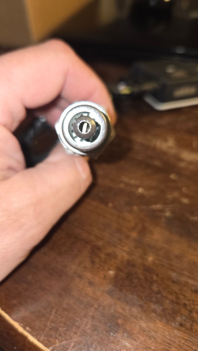

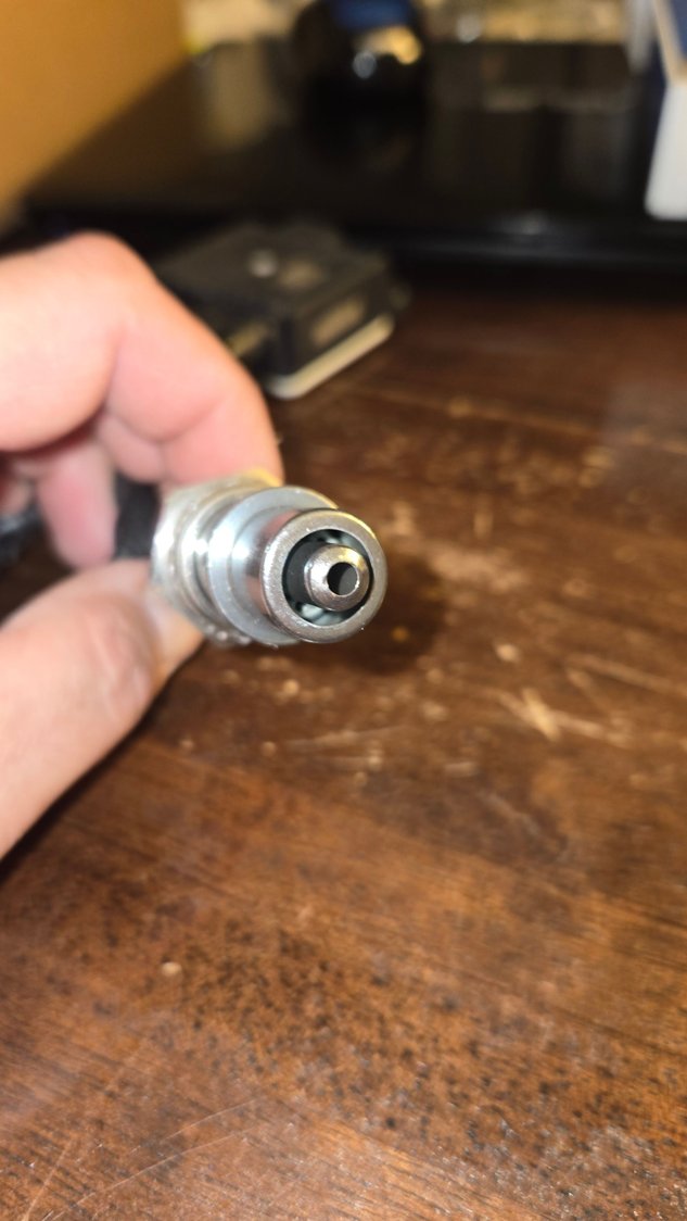

Hey Joe, here's a pic of the inside of my PM sensor, if yours is not there and for everyone else to see, for reference about "cleaning" it... I wonder if a MAP sensor safe spray cleaner would work.
I mean, it's made for an environment that goes up to at least 1200 deg F so I can't imagine a sensor safe cleaner would harm it but I sure wouldn't stick anything up in there but maybe a q-tip by those holes...
But who knows??

Now that I think about it, with the mention of high temps and whatever soot that runs down the pipe I'm guessing over time that it could eventually get pretty caked up. Probably not worth attempting.
BTW, the few times the code didn't trip was a fluke, apparently. It's back to being tripped at every startup again. In any case, I'm still awaiting shipment and receiving it. I'm at the ranch for a few days so hopefully it'll arrive sometime next week. Until then I'll just keep resetting the CEL with the iDash.
IMO, I would not be afraid to at least take a soaked q-tip (with MAF sensor safe cleaner) and clean around those holes on top on the outside... but that's just me. YMMV...
