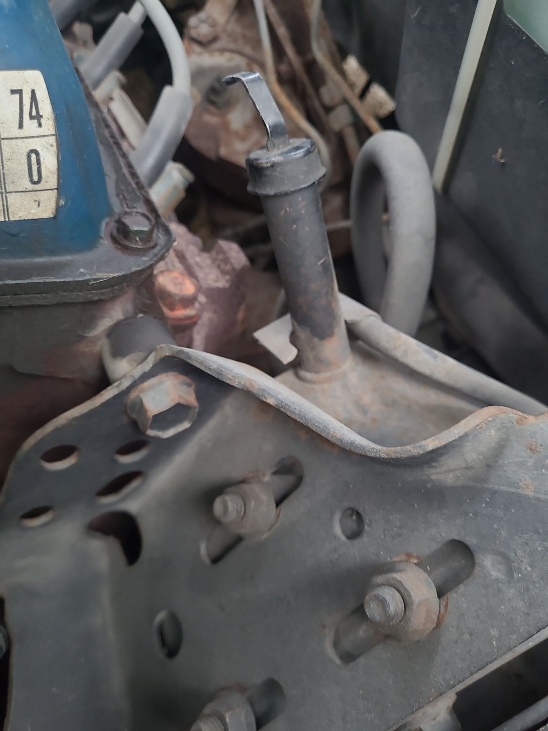

Hi all. I uploaded a picture of the pump and dip stick. Pump is some kind of steel.

I don't see anything, if it's a steel sick it's probably the TRW, or Johnson pump , but I thought '76 was the end of those.
Either way I'd use DEX/Merc .

Yes that is a older Ford design pump, so no big plastic cap with a built in plastic dip stick.
"You must bleed the system of all air before you start up your truck. You do this by removing the return line from the pump, fill the resivoir with fluid, turn the P/S pulley through by hand till fluid runs out the return line. Re-connect the return line to the pump and start the engine up. Cycle your steering wheel from one stop to the other a couple of times to bleed remaining air out. Check fluid level while engine is running an add more if required. DO NOT OVER FILL IT! The system will spew fluid all over the place if it is over filled. That's why the "full hot" and "full cold" levels are differant."
