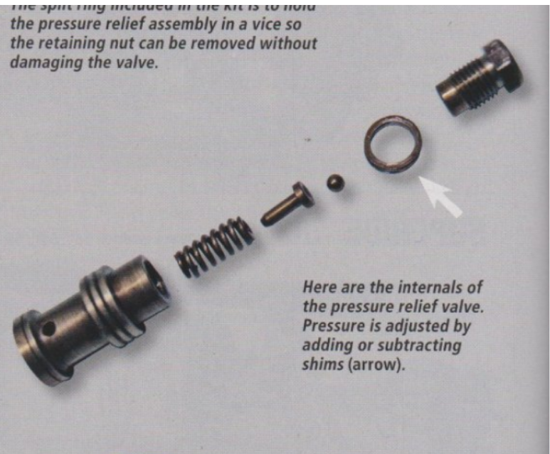

found a site the produces shim kits for the saginaw pumps. 18.00. I asked them if it also works for the C2 ford pump.
when you take the pressure line off the pump and unscrew the fitting, using a magnet the relief valve will come out with the spring.
the kit comes with a sleeve to surround the valve which you can then put in a vice to remove the innards of the valve. adding
shims will reduce the pressure. I'll try adding a couple and see what that does.

yes. as i said, its quite literally the exact same, as ford was copying saginaw to make the c2 (yet did it so terribly that a great pump becomes terrible lol)
you can literally swap a flow control valve between them , so the parts to mod one should also work for the other. remember, you need to be inspecting the smoothness of the valve outer part to make sure its not showing a lot of wear, if it is, id either suggest another pump or a GM used or new flow control valve.
I suspect that the metal quality of the ford valve may be less than GM but i do not know for sure.
you also should really put a inline magnetic filter on the return so you can prevent metal granola from wearing the parts , if that were a factor now or in the future
