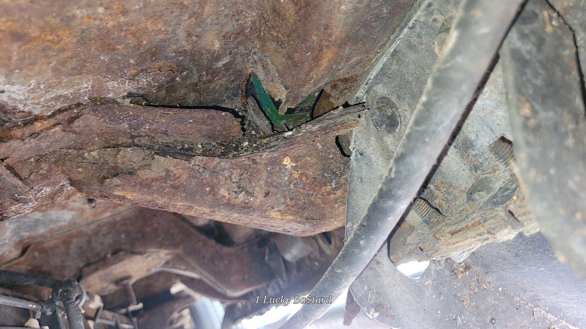

It started to stall at red lights/stop signs only after driving(not at cold or warm starts). I replaced both cam sensors 2 times. Replaced both VCT solenoids. One was broke in half. I took it to Ford & at first they said $3,500 for timing chain replacement. Week later they call and say (we refuse to work on your truck because the oil passageways are partially clogged and frame is starting to rot. Even with a new motor it wouldn't be worth it. Please pay $250 so you can come get your vehicle)!!!

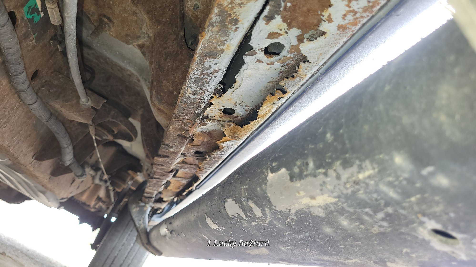

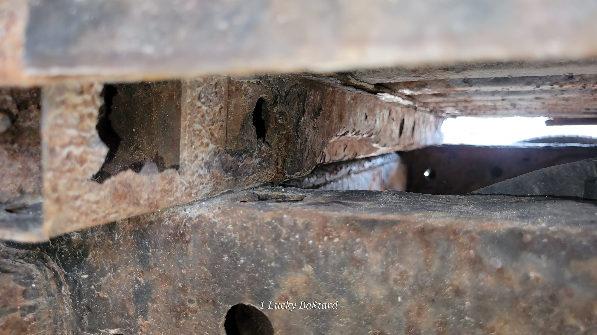

It sounds like the dealer diagnosed timing chain issues, and if I'm guessing right you have a 5.4 and the timing chain guides have gone bad. No amount or replacement solenoids and sensors will overcome this. With the solenoids unplugged, the PCM runs off of an assumed map that isn't as efficient or powerful as when the engine is working properly. It appears that this is where you are now. If the timing chains and guides need to be replaced, there's not really a way around that. If the oil passageways are all plugged up, likely due to poor maintenance, then the engine might not be worthy of a big repair like this without a complete overhaul. If the frame is badly compromised, this also might be a reason to not repair.

This is probably going to get really expensive. Like…I would go for a remanned engine in your spot. Of course, the truck is rusty, so cutting your losses now may be a better bet. 🤷🏻‍♂️

You are one lucky person to have purchased a condemned truck, but at least lucky enough to find some people willing to let you know before you sink thousands of dollars into a lost cause.

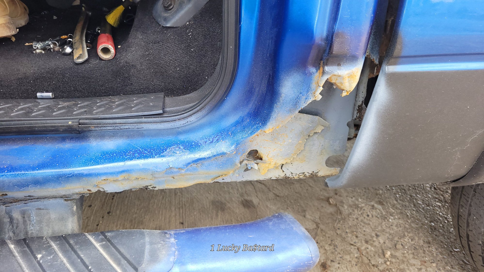

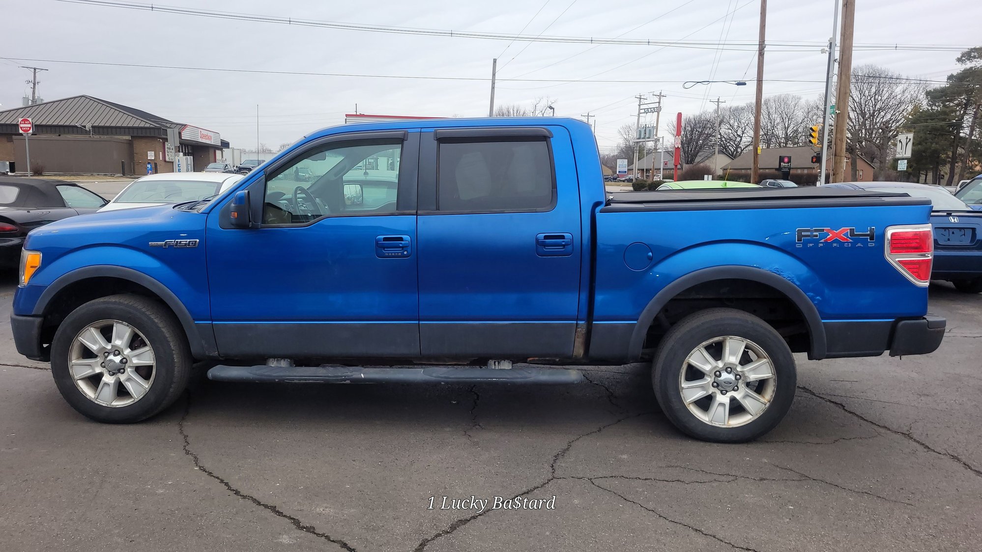

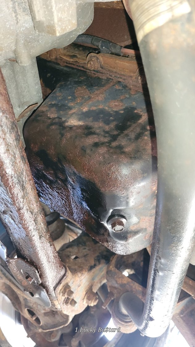

Here's pictures of my truck and all the rust.
