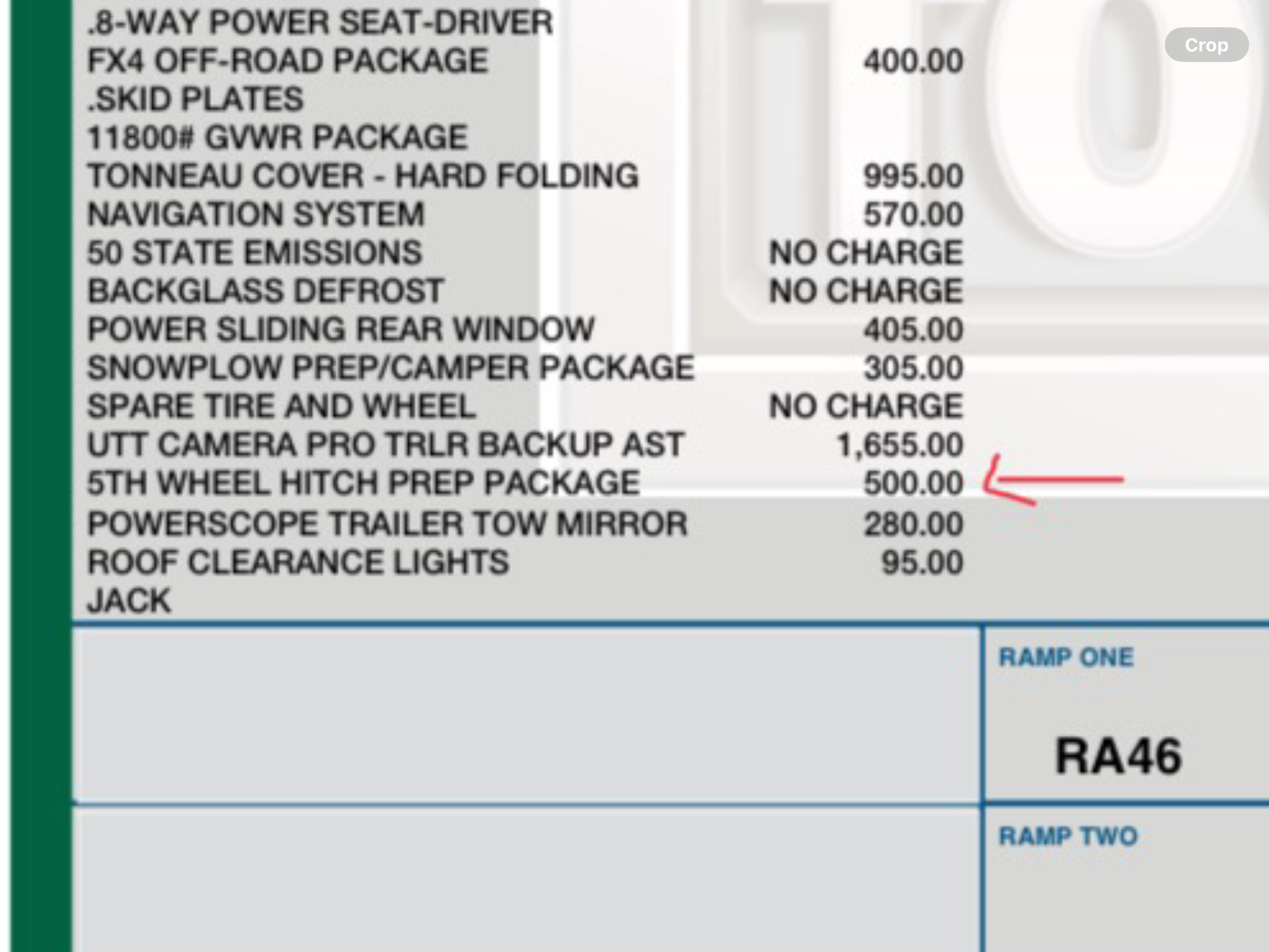

This is how the fifth wheel/gooseneck prep shows up on the window sticker of my ‘22
