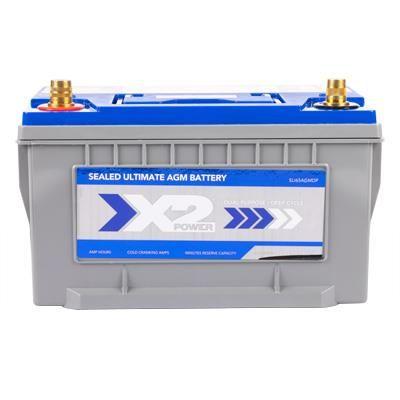

Of course AGM batteries can be found that have CCA more than 750. Mine are 930CCA but they may be a bit cost prohibitive to some depending on what your budget might be. Mine came with a five year warranty but I see now the warranty is four years.

$360.00 each for the X2 Power AGM, no thanks.
