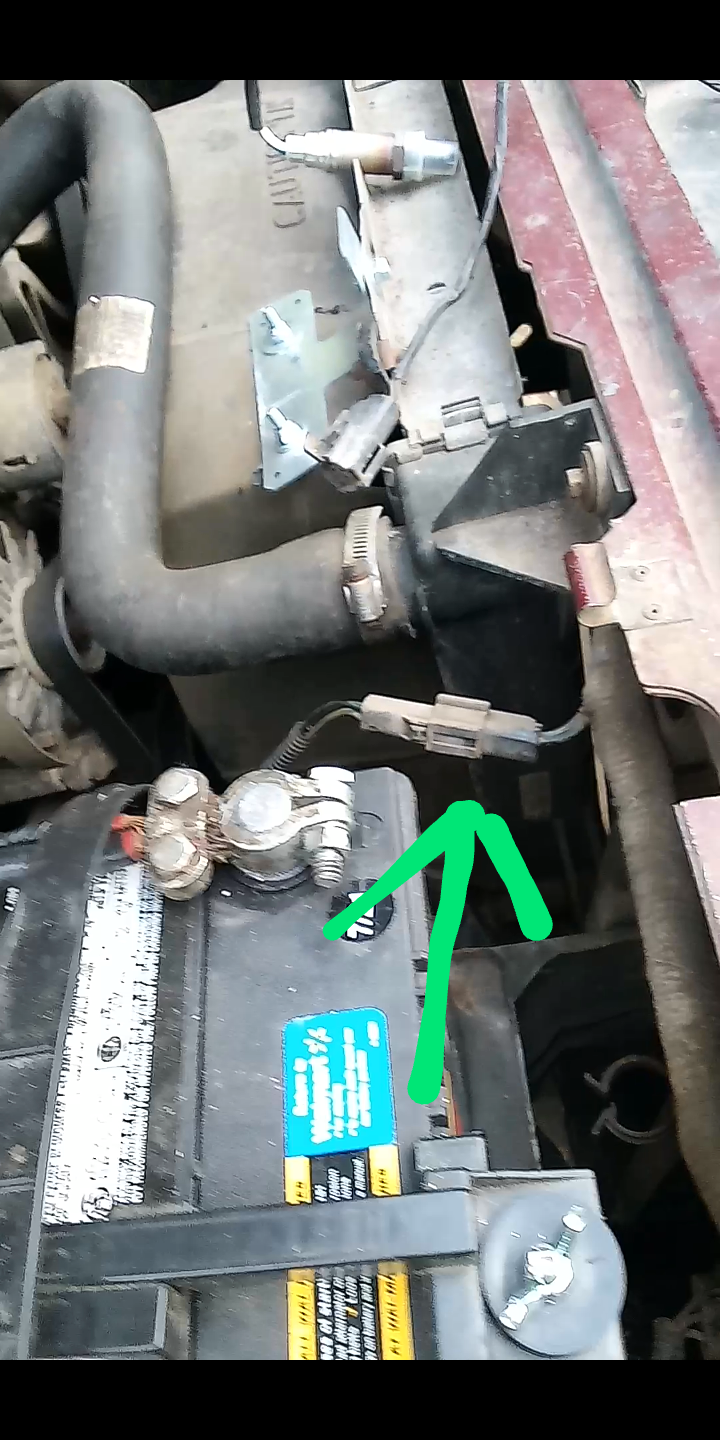

As far as the crank no start goes, did you disconnect the battery negative terminal during the clutch job?
If so, check these two wires. They need to be connected to the battery negative terminal. They're the power grounds to pins 40 and 60 at the ECM.
Also check the inertia switch behind the clutch pedal. If the red button is popped up, the fuel pumps don't get power.
When you rotate the key to the run position, with the hood open, you should be able to hear the fuel pump relays click, and you should also be able to hear the high pressure pump cycle on for 2 seconds.
