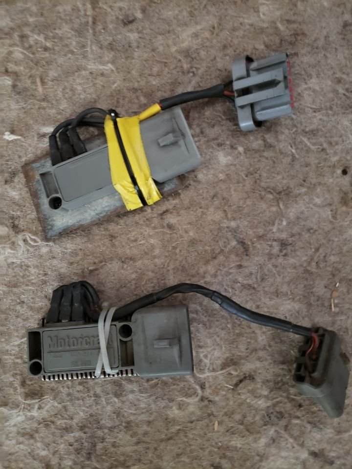

whats the ICM look like, color and wording/part number? Picture?

You have checked the ohms of your coil wire?
How about the center terminal; of the distributor cap? Is that little ball loose in the plastic or does it have the newer better spring loaded contact?
By the looks of that TFI module connector, it might have trouble there
