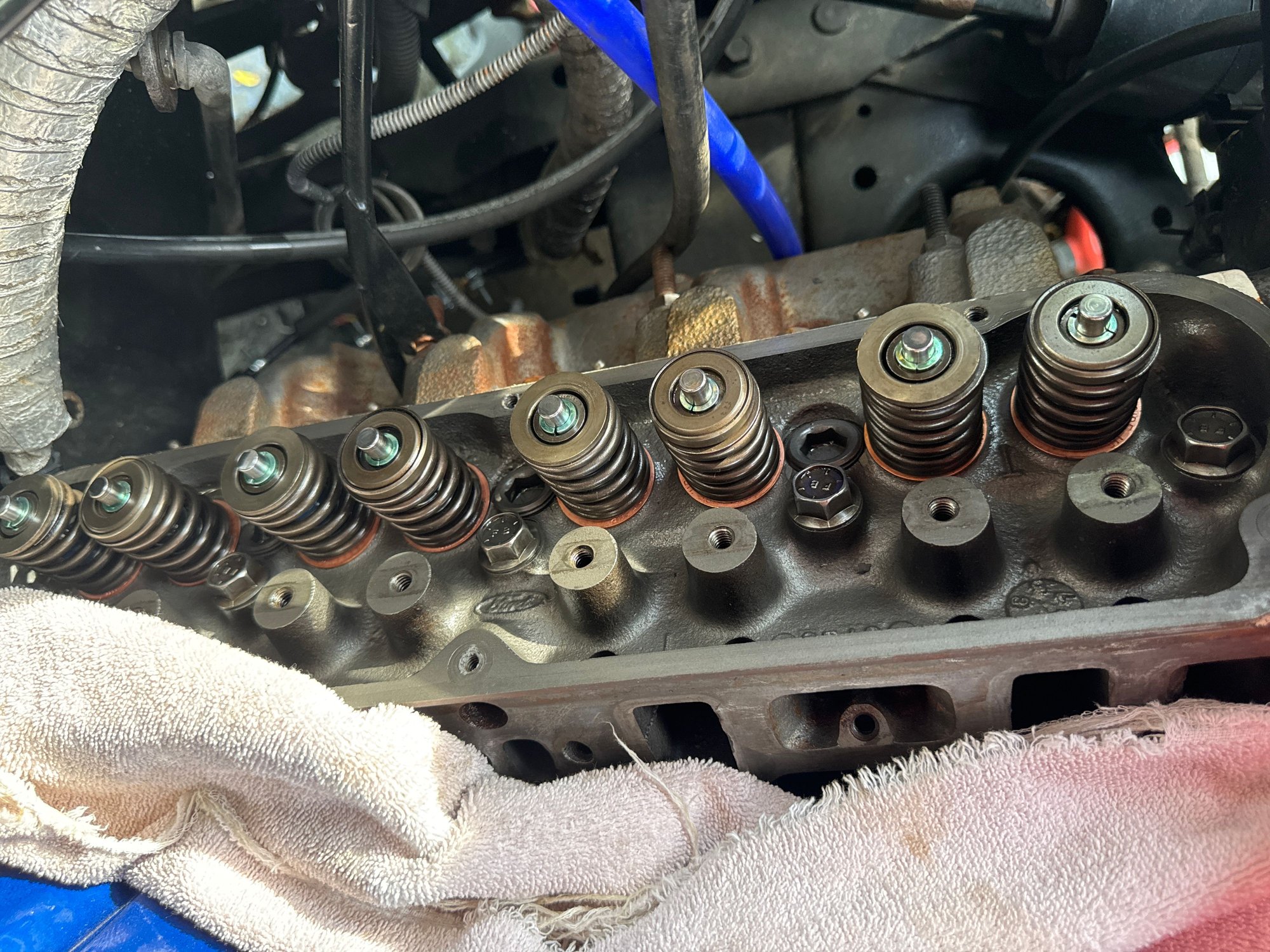

This is what the springs look  like incase u can tell from a photo the cam shaft ,lifter, rocker arms and push rods are all Melling so I would assume Mabey the springs are Melling also

Not knowing the specs at all, but fron shopping springs not that long ago, that looks like a slight upgrade from stock. Single spring with damper. Agean not knowing the specs, but looks like it might be a fine spring for your new EFI friendly cam.
that sounds about right because I know if they arnt stock they are one spec above stock but ur the man thank you was just worried these wouldt work with that cam but I did call comp and they said stock ones would work fine to so hopefully I’m either stock or just a step above
