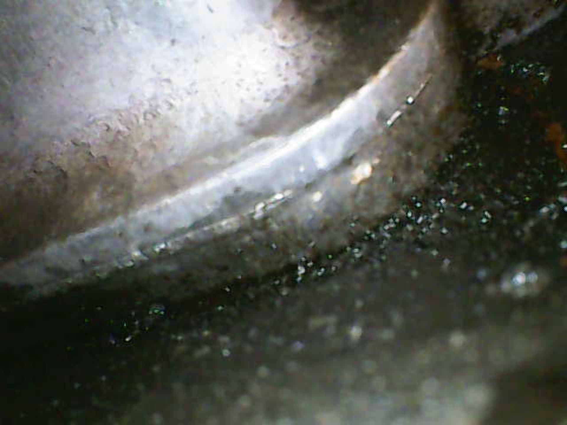

I noticed a coolant puddle at the front of the truck of sufficient size to warrant an investigation.
No obvious source with the engine running, the fan was pushing it everywhere. So, I removed the fan, fan shroud, and diverter, and then cleaned to front of the engine as well as everything forward of that point.
Refilled system and started the truck.
I have coolant running down the housing on the passenger rear of the cold side tube where it bolts to the intake - from there it drips down to the heater hose tube where it bolts to the front cover, and then onto the belt, which slings it over to the passenger frame rail.
While running, I can see an occasional puff of mist that appears to originate below the cold side tube from the general area of the fuel filter housing.
I have a bore scope, but without a specific area to investigate, I haven't found anything.
Any thoughts/suggestions would be appreciated.

Possibly the intake donut.
I'm confused - I was unaware that there was any coolant flow in the intake?
I am now better educated...I'm guessing that those orange/pink drops on the right shouldn't be there?

Pass through from the EGR cooler flow to the front cover.
