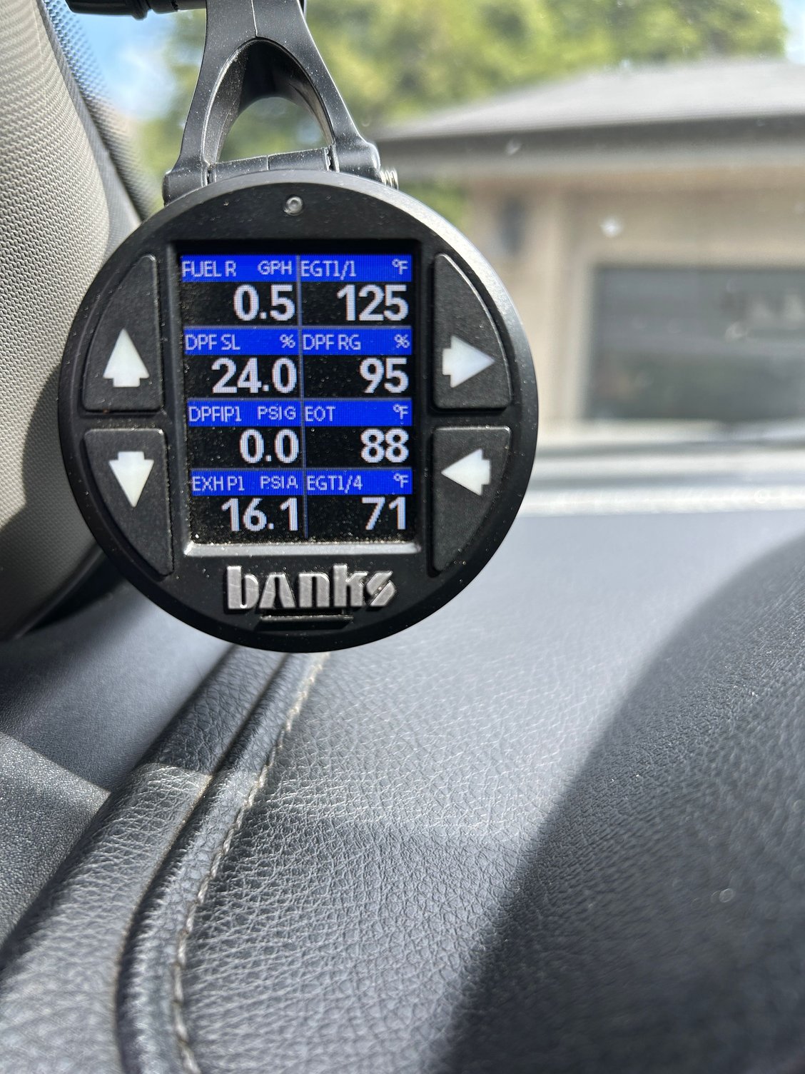

2019 PS 6.7 DPF Soot Level % vs. Regen %
Originally Posted by Walleye Hunter
I've been reading that they automatically regen at about 500 miles. Have you kept track of your mileage between them?
thanks for the reply…. I’m probably not even at 200 miles by the time regen = 100%. But I’m doing local driving not much on the freeway. Usually the soot level has to reach 100 as well as RG in order to trigger…. I have the inhibit on so I can control it manually….. I don’t know what else would make it trigger if soot equals only 25%
If soot was at 25% and you were close to 500 miles, it gets automatically tripped by the ECM like previously stated). My last one out close 500 miles (498 miles actually) with 80% soot load (on truck). I use an iDash to monitor regens and other PIDs.
I started using Pittsburgh Power's rebranded Better Diesel, Max Mileage a few years ago but now use it with their Flashpoint additive in their recommended dose of 40% MM to 60% FP in a 16 Oz bottle.
Your local stop and go routine is why you're out that short for a regen because EGTs are not hot enough... I daily drive mine, unloaded, but my saving grace is that I live in the hills south of Buffalo. Truck gets hot on the way home as it climbs. My last regen was about 440 miles out. I do them on the expressway I drive into work and home.
thanks for the info Overkill2… Ive attached a pic of my iDash…. Almost ready to regen with soot at 25%…. I found a PID that indicates average number of minutes between regens, I’m gonna start looking at that one.
You're welcome... on the average, how far out are your regens?
The DPF Soot Level on the iDash never matches the DPF% on my dash menu. My only guess is that they monitor different PIDs or calculate differently on the value. I figure as long as neither hits 100, all is good. I really only pay attention to the DPF RG so that when it hits 100, I take it out for a drive until the regen fully completes.
