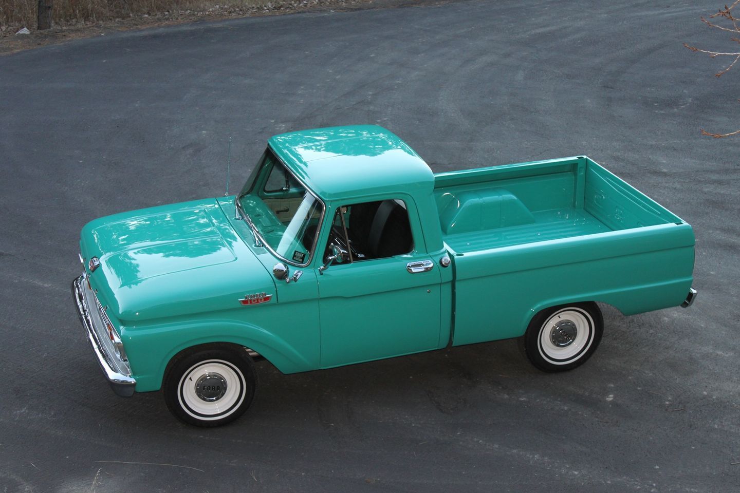

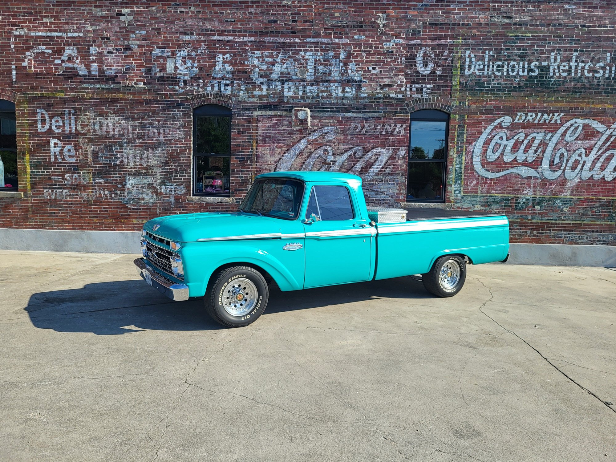

Where the bumper wraps around the fender, in front of the tire, a 67 is more vertical like the caribbean turquoise truck and a 66 is slanted like the purple truck.

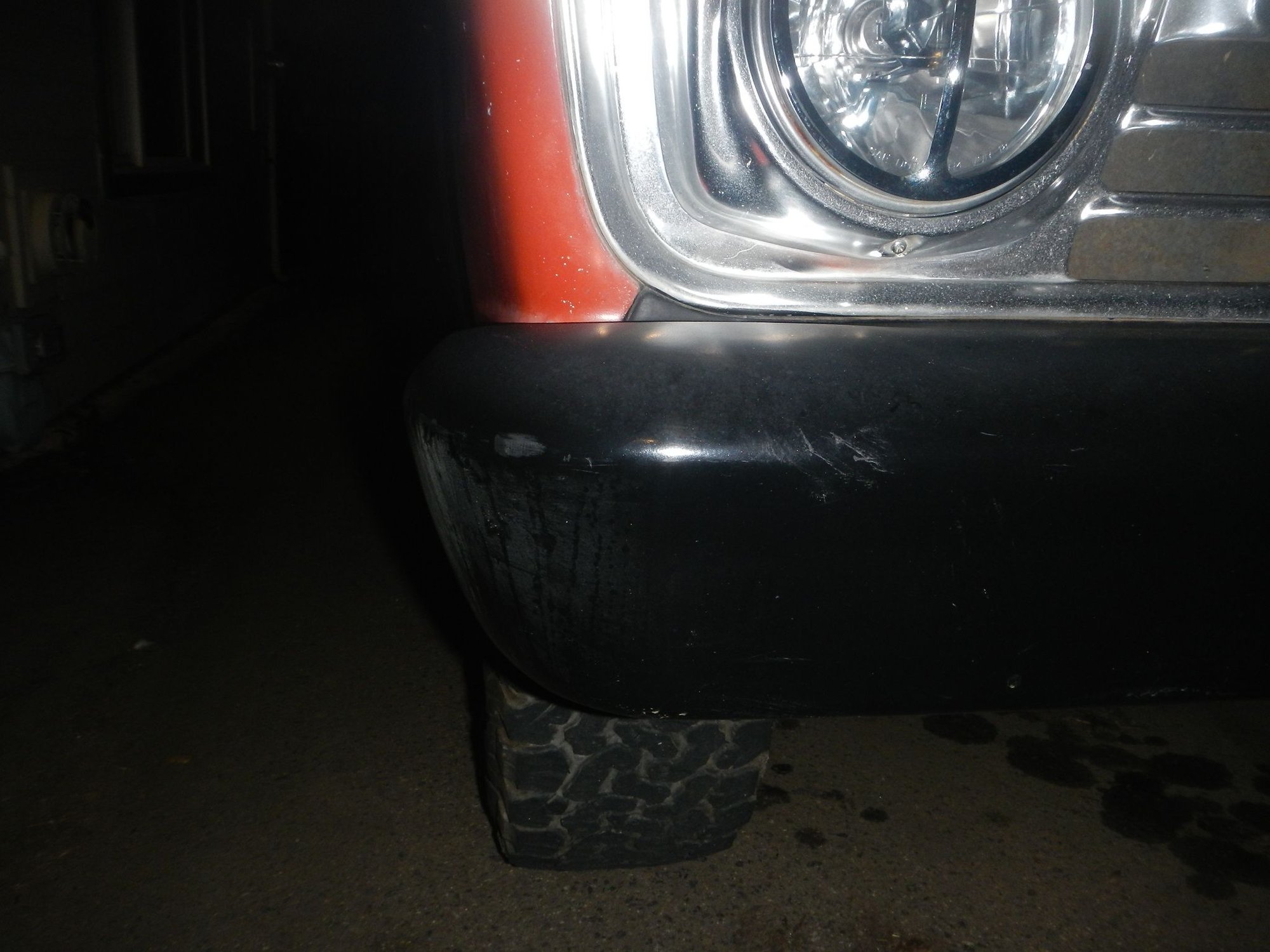

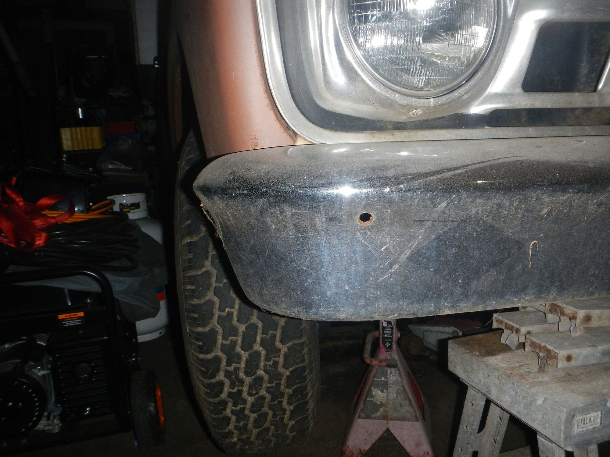

Sorry for the nighttime pics. The 67 will bolt up no problem. Only difference is the pronounced section of the top length of the bumper. 67 is flatter, a lot flimsier, fraction of the weight and thickness of the originals.
