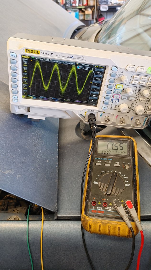

You can test the raw VSS signal with an oscilloscope. I suggest connecting it under the hood and running the wires into the cab so you can monitor the signal while you drive. eBay has cheap o-scope for about $40.

I haven’t used an oscilloscope in over 30 yrs. Especially have not used one with a fluke meter, or a new style.
Maybe you could do a ‘ How to tutorial’ someday. What it can be used for on this gen of truck, and what we’re looking at.
