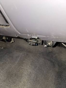

It's not an bd1 truck, the OBD2 port is on the passenger side dash just under the glove box. And you will need a scanner capable of reading trans codes such as FORSCAN, SnapOn etc.

Ok I will see if my friends Snap On Solus will read it
