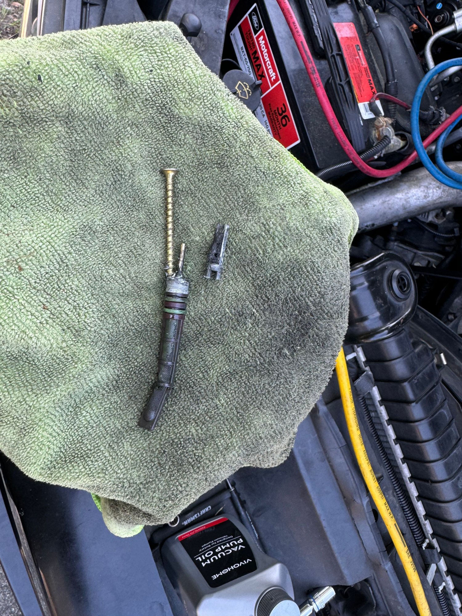

Look at that old orrifice tube…metal I expected, but hair??? What IS that?

that filter is likely the root of all your issues. if the compressor can't get a suction, it'll pull a lower pressure on the suction side. likely tripping the pressure switch. and if it isn't compressing, it isn't making pressure...so again explains the high pressure side being low.
my filter wasn't that bad, but it was fairly dirty when I pulled it out. picture doesn't really show, but almost all the mesh was blocked with some sort of weird material...and it was installed backwards.
Something else to check is the cleanliness of your evap core fins. Mine was absolutely covered with soot and dirt. virtually no airflow across it. until I cleaned it, my pressures were all over the place and was driving me crazy. pop the fan off, use a garden hose and degreaser to clean. the water will drain out the weep hole to the ground.

as far as the orifice tube...yours it the worst I've seen. I also don't understand how the various things get in them. I just replaced mine and it had a tiny leaf in it. the world of mysteries
