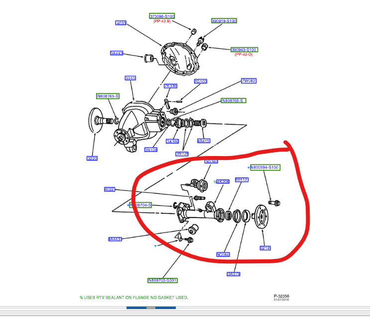

Leaking from the area I have circled? If so I'd pay the two hours happily before trying to do it myself.

Yes that's the area it leaks from, not from the front diff case.

I see so many seals and bearings in that diagram you posted.
Yet roackauto only lists one as "differential front seal"

4B413 is a bearing, 3C084 is the seal, 3A379 is a "shield". This should be the seal you need, https://parts.applefordwhitebearlake...al-2l1z3c084aa

Probably going to need the axle housing too
The bearing gets loose and eats into the housing, destroying the seal in the process

I don't have a link for a housing
I'd just hit Ford or Ebay for the Ford / Spicer part
Yes, the bearing will be wiped out and that is what destroys the housing
If your bearing is good, you will have no movement of the flange, up and down, side to side
Those seals generally only leak if the bearing goes bad, and the seal then fails shortly after, that has been my experience anyway

Shoot me the last eight digits of your VIN, I'll see if it's even still available. It does look like a multi-part supersession.

So, the tube and inner bearing are discontinued but we still have access to the tube through our obsolete supplier. For anyone interested besides the OP it would be $576 for the new tube with seals and the outer bearing.
