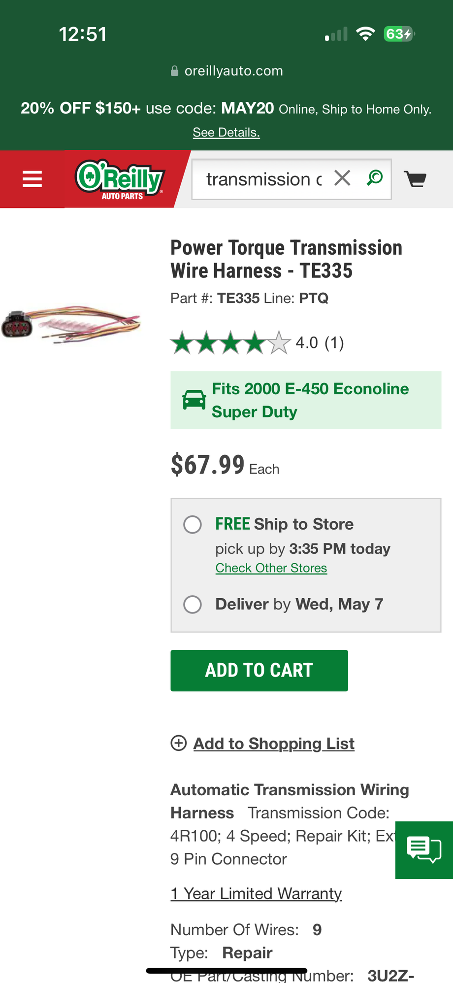

Alright, now we’re getting somewhere. Replaced the transmission’s solenoid body connector/pigtail today and cleared some codes….
Fired up FORScan, and found no codes except P1139. OD light still blinking…
Cleared DTC’s second time in FORScan cycled key off/on and pull codes again, same thing. P1139.
Cleared DTC’s a third time, then ran KOEO demand self-test. And it pulls up P1139 as well as P0743. (TCC circuit)
Started he bus, drove it up and down the street. Checked for codes again still have P0743, P1139 and P0541 (AIH deleted, code eliminator in place)
Transmission code is main concern right now. Guess I’m going back to the pinpoint tests tomorrow…
Also, I purchased a PC/ED manual on eBay for $65. Great book to have, definitely recommend having one or getting one of your own….
Here’s the pigtails I used for future reference:

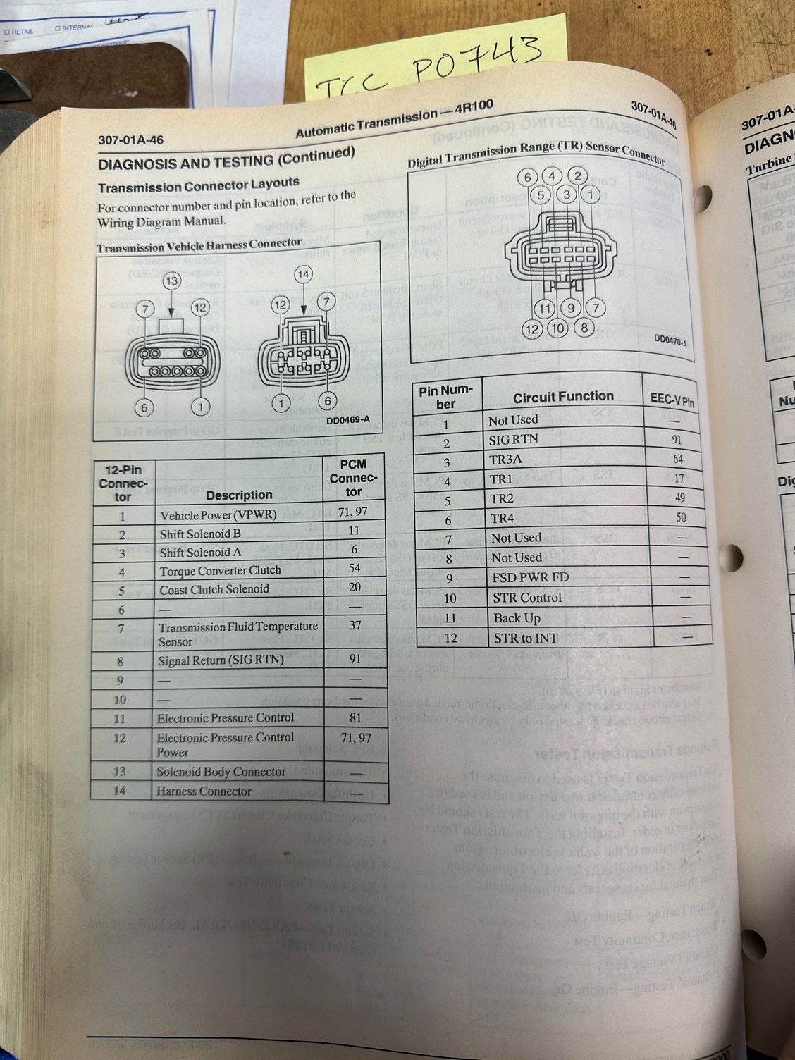

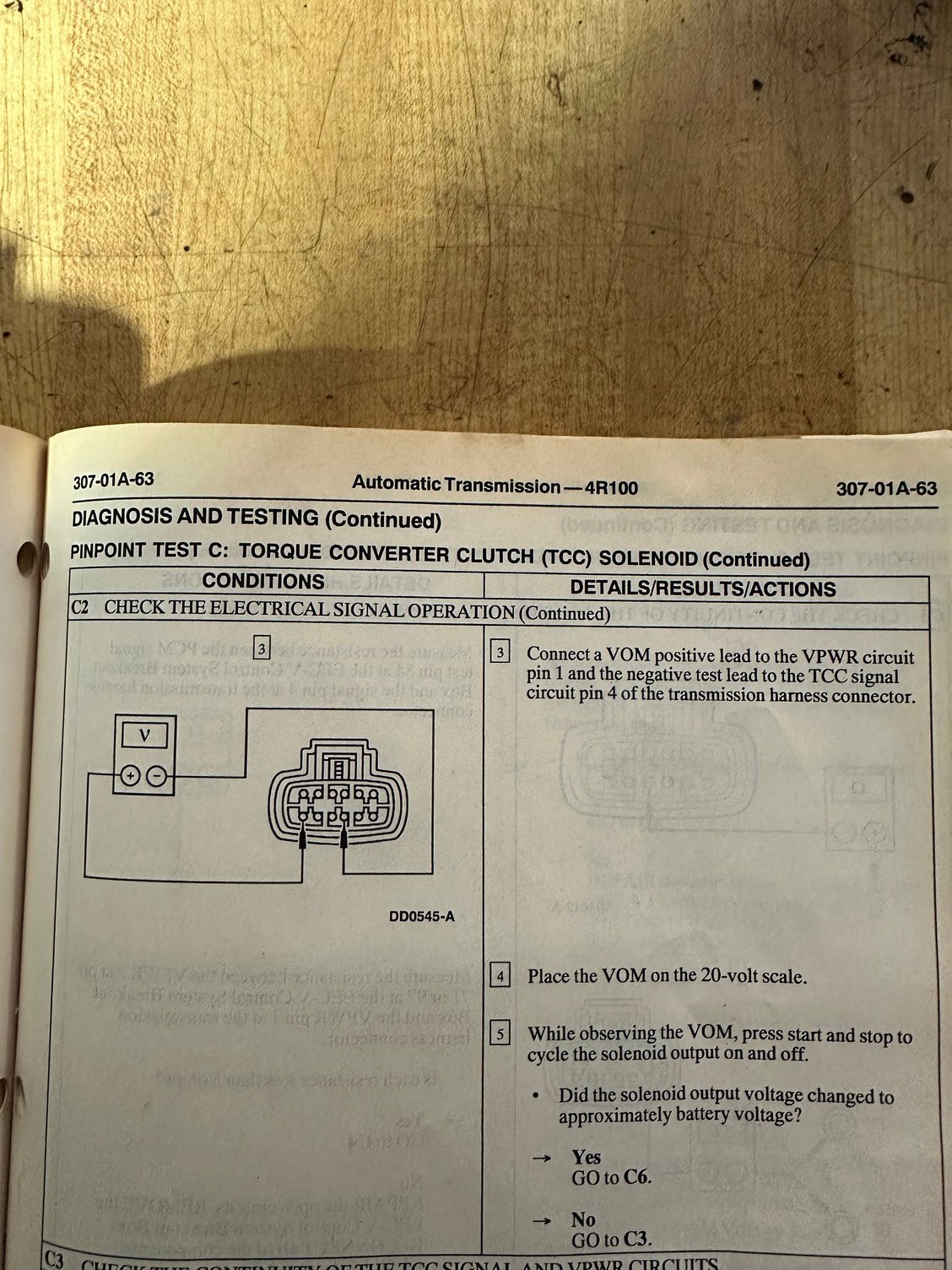

Going through TCC pinpoint tests tonight. And made it to step C2 and I’m a little confused.
C2 tests voltage at the transmission connector. My battery is 12.72v and KOEO. At the transmission connector I have 12.45v.
Basically it is not exactly the same voltage as battery voltage and this leads me to C3

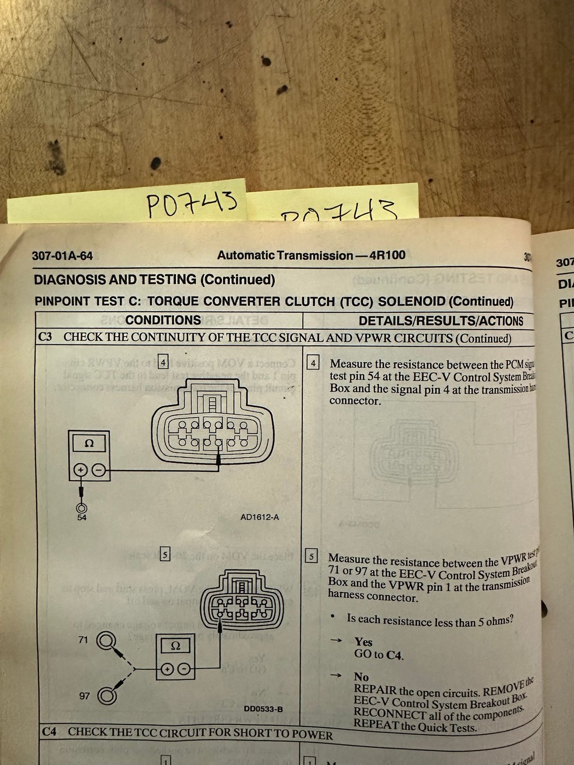

C3 wants to test continuity of TCC signal and VPWR circuits. It is really tough to get to my pcm pins considering the bus has a second A/C compressor that’s right in the way. Would it be worth it to get a breakout box for this step? Or is there something else I can do to test this?
EDIT: after thinking about it. Step C3 is basically asking for continuity/resistance from the pcm connector to the transmission connector. Correct?
If someone with experience could confirm for me that would be a great help. Thanks.

I don’t have experience, but do read that as resistance in wire between PCM and Trans connector.
But I also would consider 12.7 and 12.4 volts as “appropriately the same” back in step C2.
I’m a little confused over the procedure though. I won’t add my thoughts or it may cloud up what you already know.
If step C2 was considered yes, what is step C6?

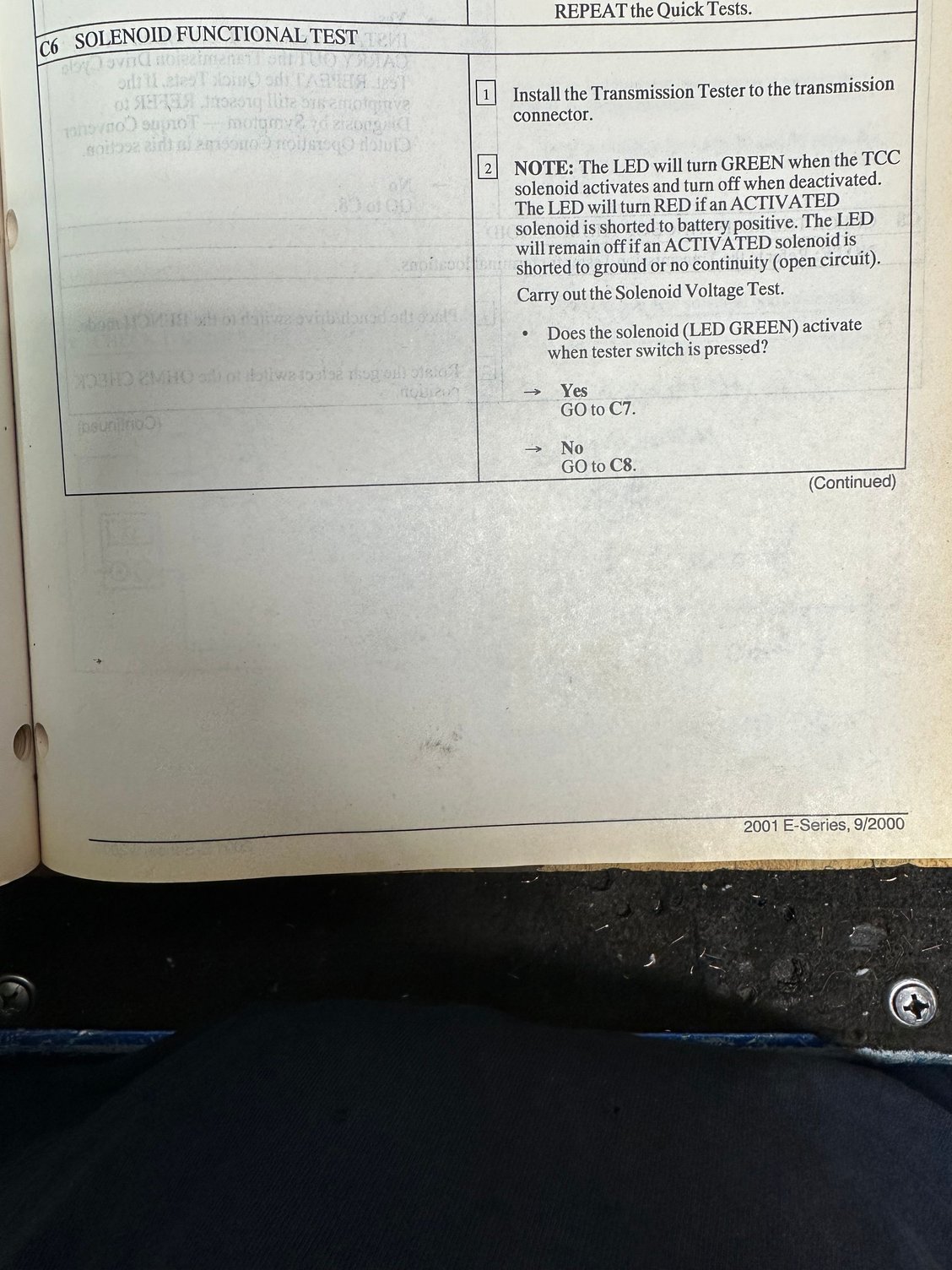

C6 is a solenoid function test. And again ford wants to use a transmission tester and/or breakout box. I’m not sure how to do this one either…

I would think a resistance check of the solenoid and checking for no short to ground (maybe no short positive battery too based on the wording) would accomplish the same thing.

Alright. Confirmed continuity form the trans harness to the pcm, all good.
took the bus to a shop to confirm and continue the work. Replaced the solenoid pack, and upgraded the accumulator valve body and it’s driving like a champ!
