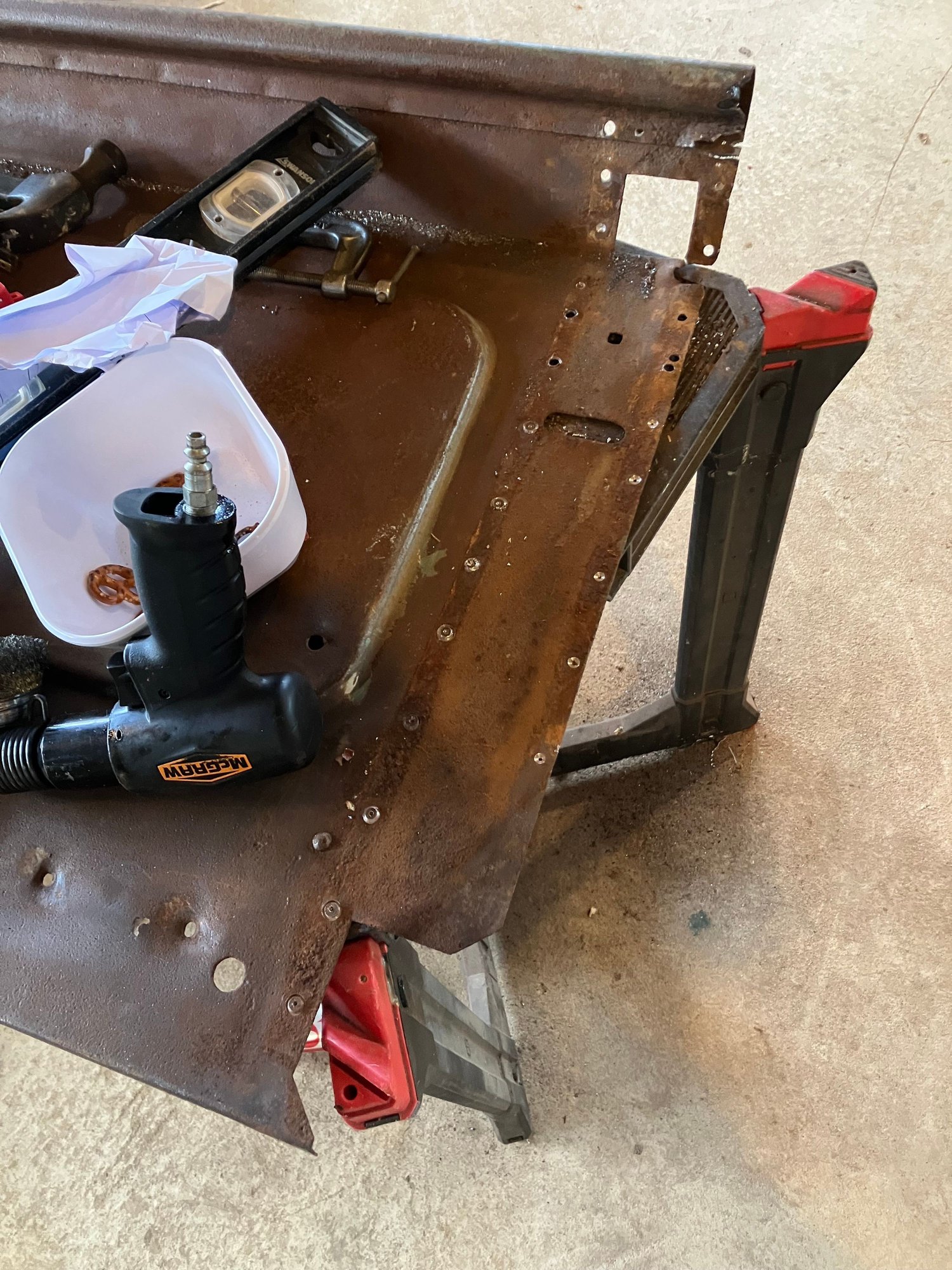

What is the best way to remove these rivets and spot welds on the stake pocket?

For the rivets, i would drill them out. Start small and work up till you know what size bit to use. Or take a grinder carefully to the head them punch them out. For spot welds, I used a spot weld removing drill bit.

Spent the last few days working on replace a stake pocket, rear cross piece and tailgate. It was pretty difficult at times working by myself and the fact that the truck was hit in the rear at some point which did some damage to the bed sides. I bought two side beds over the winter. The one side wasn't much better than the one currently on the truck but I was able to use the stake pocket and put it on the truck. I decided to bolt it on. Still need to do some work on it but pretty happy that it is back together and functioning how it should. With my limited knowledge, tools and skills I am pretty happy how it turned out.
