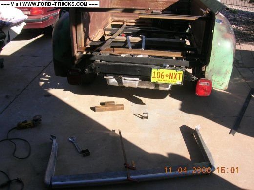

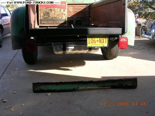

Way back when, I built my own lower bed piece. I bought the stake pockets. I then took some 2x3 rectangular tubing and ripped one side off, I nestled that over some round tubing to mimic the rear crossmember. My transition from the lower piece to the stake pockets isn't the smoothest and could have been done better. If I were doing it again I'd buy the right parts.
My bed isn't exactly stock though. My bed sides and tailgate are stock, but I used the be floor and front panel from a 2005 GMC.

I found my old pics;

Looks really good to me!!
