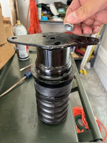

Factory bumpstop removal
How TF do you remove the factory bumpstops from the bracket? Trying to install some SumoSprings and instructions are only one page. it says to remove the bracket, then remove the bumpstop. I'm wrenching on this thing with a strap wrench and can't get it to bite. So I get under the truck and try to yank on the one that is still mounted and I can get it to move a little, but not pop out. I went so far as to push it with my foot and again, it moves, but won't frickin' pop out!

This is one video that is out there on how to do it. If you have a small pry bar you can usually pop them right off

Figured it out, used two opposing flatheads in the tabs, popped it right out.
I also figured out that the SumoSprings I ordered don't fit. Apparently DRWs have different brackets?
FML
