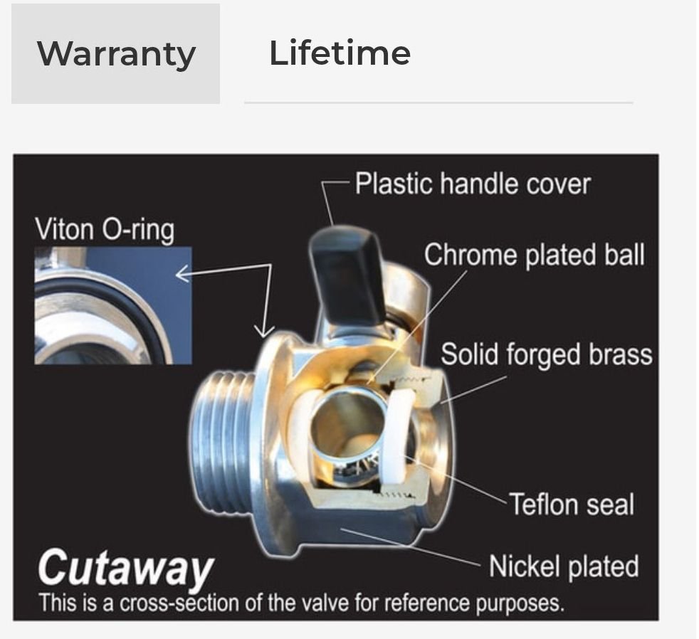

For the Fumoto valve.
https://www.fumotousa.com/
EZ Drain website...
https://ezoildrainvalve.com/
This is what I did... put a wire clamp on mine because due to my overkill mentality, I don't think it's would have felt comfortable without it.
But the Fumoto, besides being manufactured in Japan, over China for the EZ Drain, has the advantage of coming with that plastic locking ring for the lever.
I looked at both and liked the EZ Drain is nickel plated for here in WNY.
Tried looking for a pic of the Fumoto but did not find one. I don't think you'd go wrong either way.

Find product for
Cars/PickupsCommercial TrucksIndustrial EquipmentMotorcycles
Select MakeAcuraAlfa RomeoAmerican MotorsAudiBMWBuickCadillacChevroletChryslerDodgeFi atFordGenesisGeoGMCHondaHummerHyundaiInfinitiJagua rJeepKiaLexusLincolnMazdaMercedes-BenzMercuryMiniMitsubishiNissanOldsmobilePeugeotPl ymouthPolarisPontiacRamRenaultSaabSaturnScionsmart SubaruSuzukiToyotaVolkswagenVolvo
Select Year
Select Model
Find products Remember my vehicle
About Fumoto
Who are we?
Our company invented the first oil drain valve in 1976. Since then, tens of millions of our valves have been produced and used globally from commercial trucks, construction machines, generators, boats, automotive, pickup trucks, motorcycles, and many other applications.
How did we start?
In April 1976, Mr. Naoyuki Yamamoto applied for a patent with his idea for an oil drain valve. He came up with the idea when he was overcharged for an oil change at a gas station. Fumoto Giken LTD was also established later in the same year. Since then, Major engine manufacturers in Japan such as Toyota, Nissan, Mitsubishi Heavy Industries, Subaru, Isuzu have adopted our products either as OEM or “Genuine Parts” used on their machinery and vehicles.
Fumoto USA
In 1984, Fumoto Engineering of America was founded and our valves were introduced to the United States. Since then, many companies have adapted our valves to be used on their applications. To name a few, Caterpillar, Paccar, Daimler, Peterbilt, Kenworth, JLG, etc have adapted our products and used them on their machines.
Since 2015, the US Patent and Trademark Office has approved multiple trademarks for the visual appearance of the Fumoto Engine Oil Drain Valves. Those decisions by the USPTO were based on the uniqueness of our product design and shape and the long-standing history of our brand in the US market for over 25 years.
Old Apr 7, 2025 | 08:08 PM
jimzpsd's Avatar
jimzpsd
Joined: Feb 2017
Posts: 2,440
Likes: 734
From: Wisconsin
Founded in Japan, established in USA in 1984, cloned in China. Its not about the price/tariff its about the country of origin for me. I like to support US as much as I can when I can.

The Fumoto is brass, no plating needed. Mine have a little nipple on the end of them too and a hose with a connector that pops on there whenever I'm doing a drain. Makes it much easier to ensure that everything ends up in the pan.
