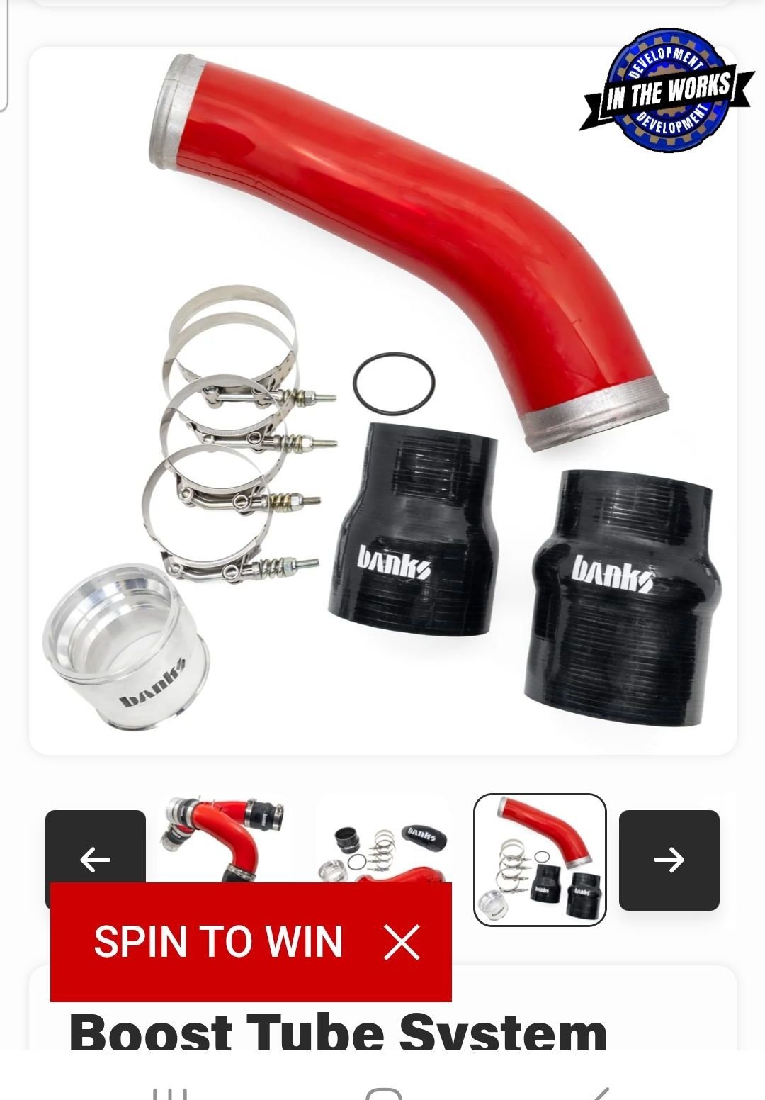

All aftermarket pipe kits are 3 inch which I'm not saying are bad as that's wider than the stockers but Banks are coming out with their CAC upgrade pipes that are 3.5 inches. Just FYI...

What's weird is the 11 to 16s have a 3 inch lower outlet in their factory CACs but the Alumina Duty 17 plus trucks have 2.5 inch...
Still like the way Banks is going to do it with their 3.5 inch ID pipes... more gradual and smooth...
But red is not my favorite color...
