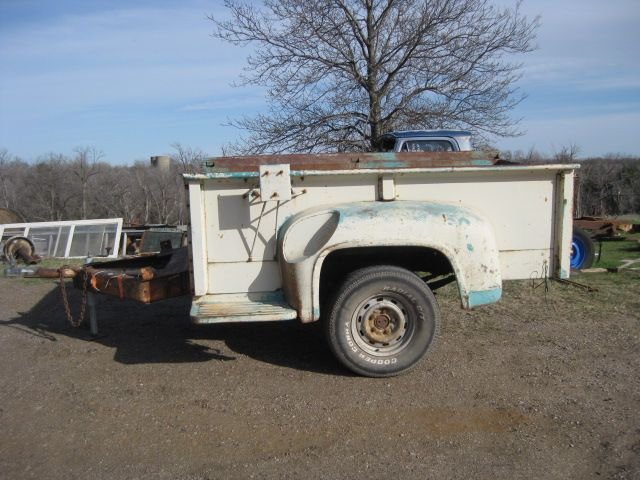

You said nothing bad, its American humor. Both truck frames do not have your hole B, however, a 3rd frame I have under a trailer I bought for the spare tire setup, has the B holes, they are empty. happy motoring.
