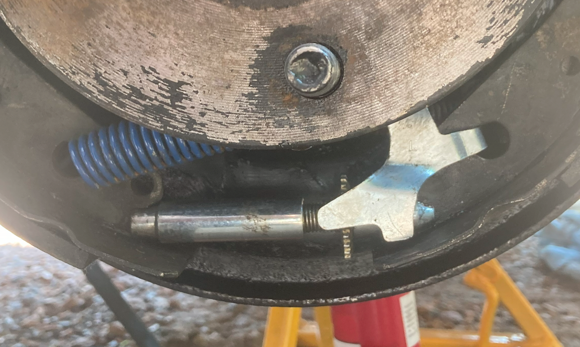

Send pictures
Without consideration to anything else, this here is an example of poor quality aftermarket parts , this is the rear drum on my 1996 with aftermarket adjuster parts. See how that lever is not horizontal and in line with the screw thing?   That would, if you kept using it, lock up too.  The shoe question above is also important
