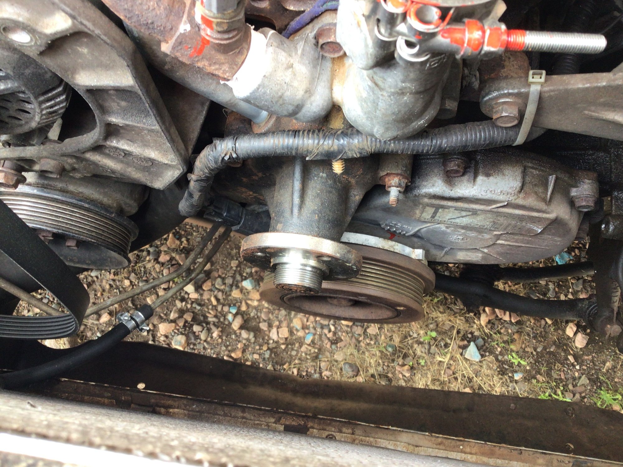

my trans puking from low load not towing just driving became from my restricted cooler line in a kink near the radiator on the lower line, larger diameter would have been good factory to mitigate this, but i also had restriction on the cooler but i was able to clear that, but the rusty fitting/line failed before it could release while i tried to work it ol, so I bypassed, but now it doesnt warm up. i have a cracked end tank anyway, so i eventually i will fix it right but id probably get the 4r100 bypass, put a new spring kit in it , and then get larger diameter and use the same time to properly plumb my aux cooler
here i cut it the first time as far high as possible , but then i couldnt get a flare tool on
plus a flare tool wouldnt play nice with this being partially folded
I cut it a bit further so I could have a more round pipe and reach it from below AND get the flare so I could put a simple flare on , to encourage my hose repair to stay
The line uses is sunsong trans cooler line, which is fantastic very durable and stiff (less likely to kink, more abrasive protection) and two fuel injection clamps , opposed to each other
This hose combined with the clamps done this way, would have worked without a flare
But it gets quite cold here, and Id like to minimize my chances of it popping off in cold one day and losing my trans fluid quickly especially being sprayed near the fan lol. messy. Simple flare , it was. but in a situation where you have a short bit of pipe rusted out or pinched, you could safely bridge the pipe with this method and using 4 clamps between a section, youd very unlikely pop it off. just a cool trick might help someone. same situation as PS return lines
