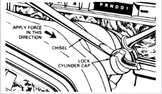

Originally Posted by Dnix86
Without the key being able to move forward how the hell do I get the ignition tumbler out
Had this happen to my 89. It's just old and wore out and the ignition switch tumbler fell apart. They sell them at the autoparts store with new keys.
Get a large screwdriver or chisel and a hammer. Put the chisel or screwdriver behind the chrome part of the tumbler, and give it a couple of good wacks to break it off. Then you can get something small up along side the tumbler and push the little keeper pin to slide it out. Believe or not, this is straight from the factory manual.

Here's a picture from the manual.
