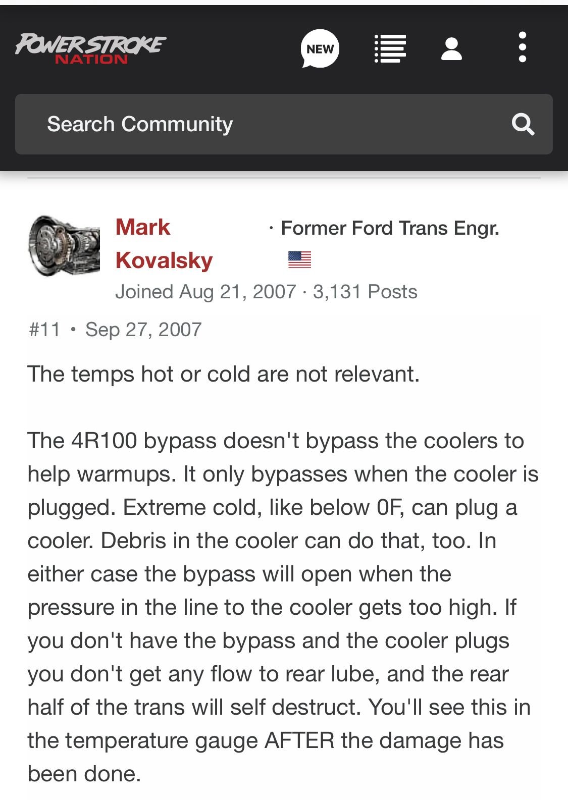

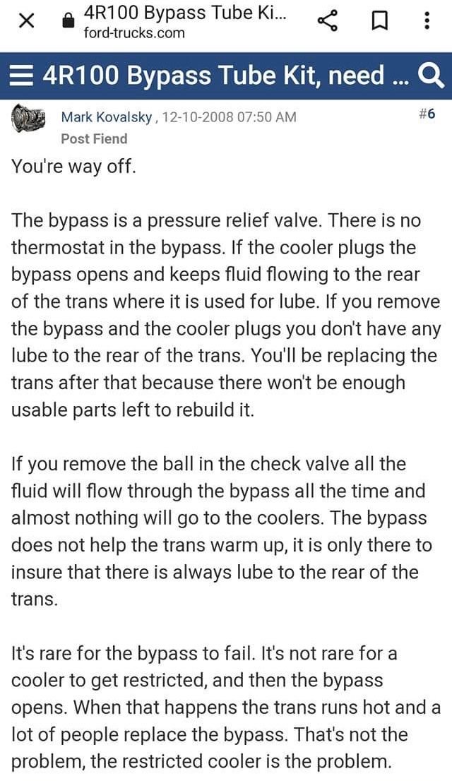

I don’t recommend the bypass delete based on Mark’s description, snapshots below. (Yes, I save his words of wisdom for future reference)

As Jason stated don't eliminate bypass. A used cooler wasn't a good idea, they hold trash and I guess for you water.
