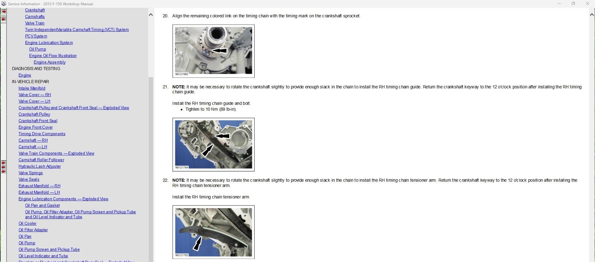

From the 2013 1st gen 5.0 shop manual.

Thanks for sharing that RL!!
I did see the keyway at the 9:00 position before they started….. it wasn’t called out though.
I got the end result with all the timing marks lined up like the last page of your manual.
So it sounds like setting both the LH and RH primary chains with the crank keyway at the 12:00 position didn’t cause any issues.
Thanks again for the help.
