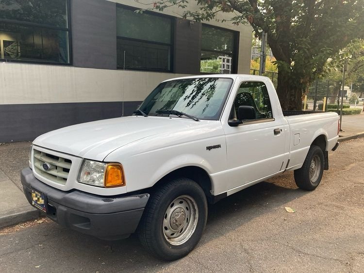

Well, it's a vacuum leak from the back of the intake manifold, the stupid IMRC shaft wore out a section of it.
If anyone can find 1L5Z9424A, lemme know. I've been looking for months and it seems like they're all gone.

Any chance you could install a newer intake manifold with out the IMRC, and get tunes to get rid of those codes?
I'm having a similar problem like you same year truck but with the 3.0, no one makes or can't find an intake manifold, I patched mine up with TA-31 sealant it worked but I would really like to find a new one.
Old Apr 4, 2025 | 04:30 PM
King of Mercia's Avatar
King of Mercia
4wd High
Joined: Mar 2025
Posts: 9
That's currently my plan. I've searched all over the web and I've found many people talking about swapping to a flapless intake, without swirl valves. Three or four separate threads about doing it.
But zero of the users followed up on if it worked.
It looks like that's likely what I'll have to try doing. I don't know anything about tuning, who to ask, what to look for. If anyone knows about tuning lemme know.
Edit: I believe it's EEC-V and there is no CANBUS in a 2003. I've seen posts online about tuning to get rid of IMRC, but it's either for high performance cars or Focuses. Dunno about a Ranger.

Also if you don't mind this one, it's available used for your 3.0.
https://www.ebay.com/itm/116060322449
If I didn't have IMRC I'd have no problem with a used one, but the IMRC makes the 2.3L intake effectively a wear item. Idiot engineers.
Last edited by King of Mercia; Apr 4, 2025 at 04:42 PM. Reason: added ebay image because the link will not work in a year when someone else finds this
