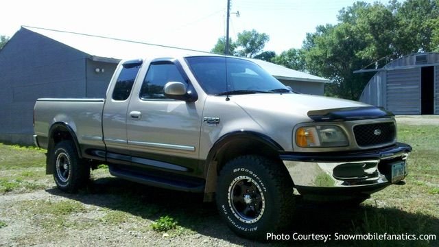

What is meant as encouragement? The OP’s truck does not have control arms but a light duty does.
1997 Light Duty F-250
