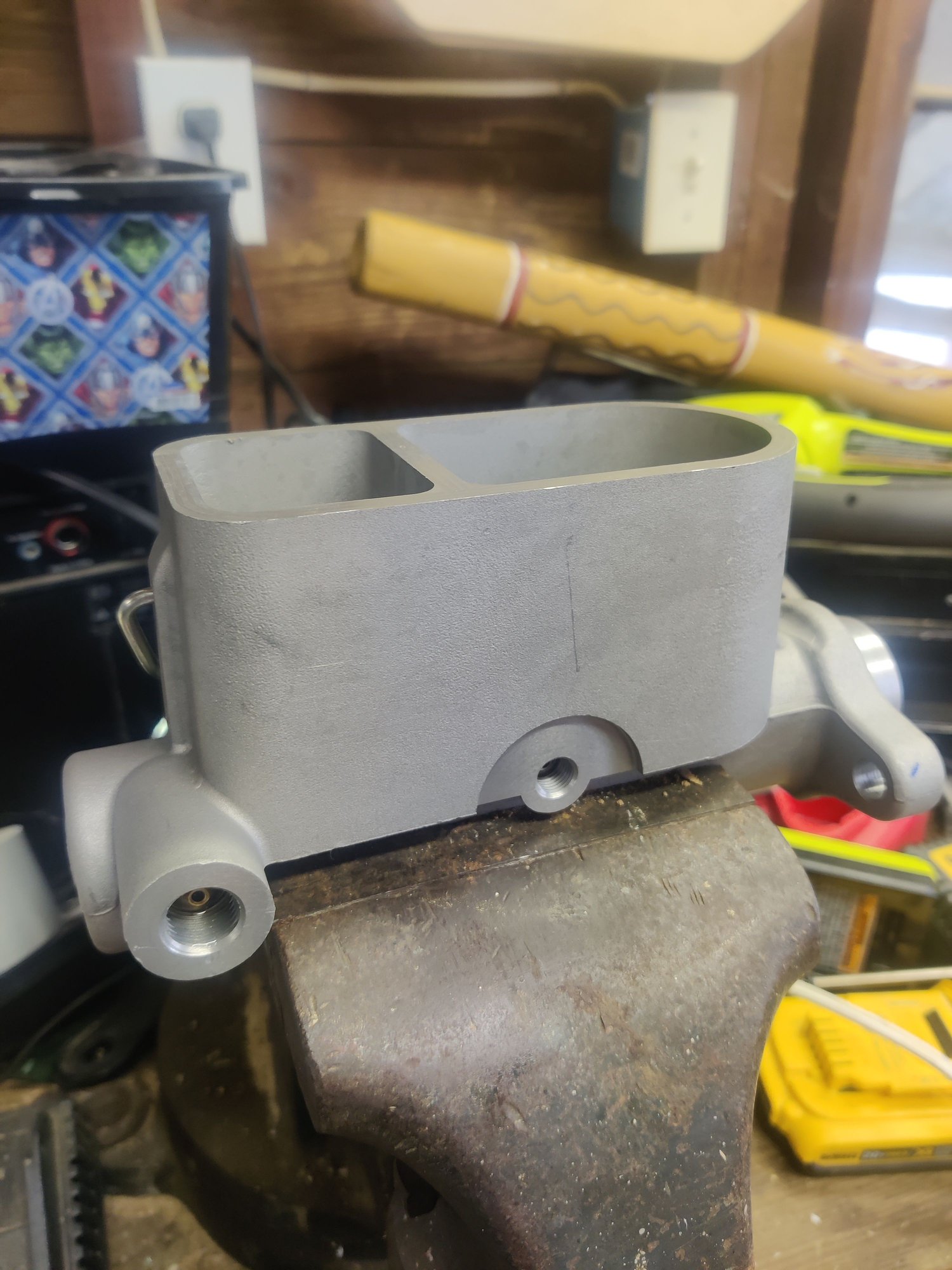

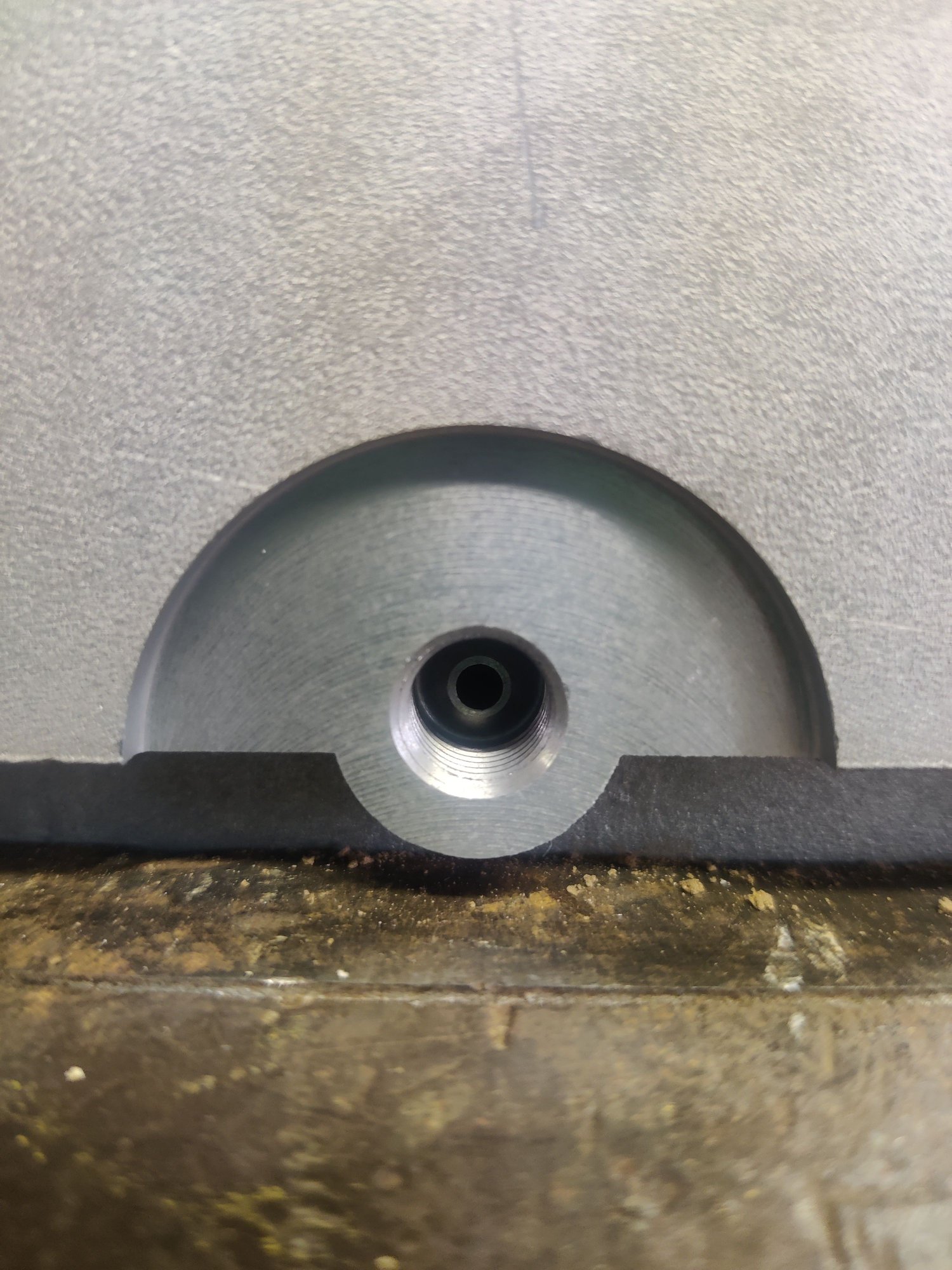

I bled it, yes. UPDATE: returned the MC, got a new one - SAME PROBLEM. Only one valve pumps fluid. I know this from putting it on the vice level and pumping it. This tells me there must be something I'm missing, some step or information. The front valve (which goes to back brakes) works great, flows well. Bone dry out of other valve. What is going on?? I pumped long enough to empty the front tank and refill it once. I'm getting very little, if any, bubbles out of the big tank.
