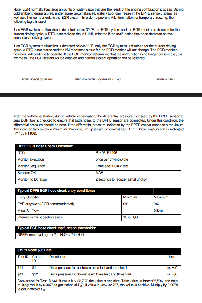

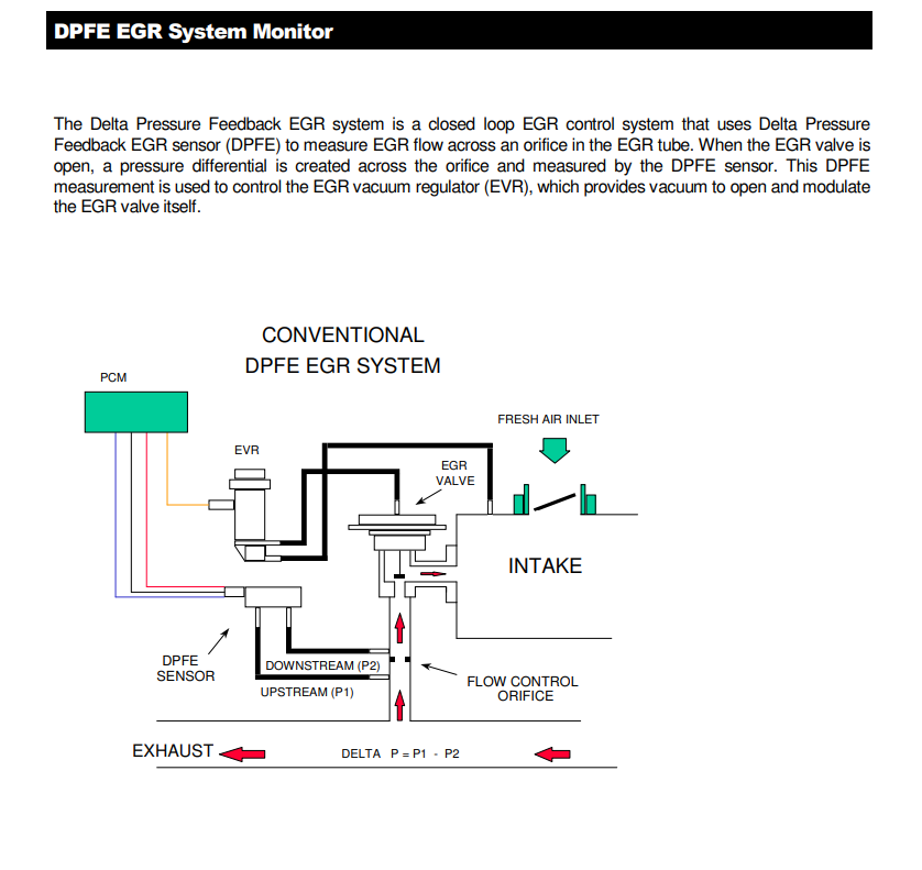

the O2 sensors know when the system should be diverting air to the exhaust, which it can detect, and the air would also function to assist the 2 way cat
if it doesnt do either of those things, it knows theres a mechanical issue in the AIR system somewhere. Check valves, pump, pipes, etc.
It needs to run these tests more than once to eventually throw a code confidently
heres some info on the 96 4.9
