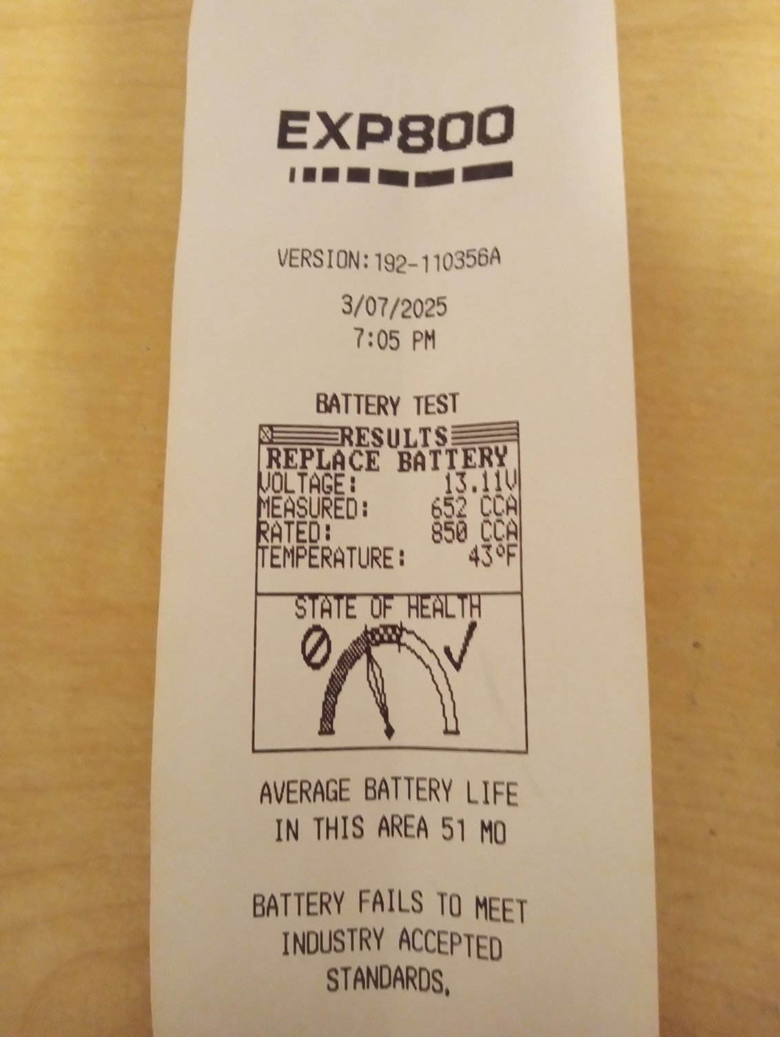

I Tested my Interstate MTP65HD battery it's roughly 6-7 yrs old (can't confirm exactly as I can't seem to find receipt)
It was rated for 850 CCA and it tested at:
652 CCA with 13.11 volts....
The engine was off during the test.
Is this weak in your opinion?
The battery tester printed out a receipt indicating time to replace.
Was thinking of buying motorcraft BXT 850 CCA
any opinion?

You need a battery. But I would look for a battery store. One of those places that sells new and rebuilt batteries. Save quite a bit of money. And they have never let me down. Off the shelf ones have. Motorcraft will be expensive.

Hard to tell, those test results are weird. What kind of tester? 13.11 volts? Vague "industry standard" message. Cold cranking amps are still pretty high.
NAPA has a pretty good deal if you pay over $125. 20% off. I joined up just to buy a new NAPA Legend battery. The one I replaced, same brand, was ten years old and still worked great. Batteries tend to die suddenly when they get old though. That's the main reason to replace them. Age.

The tester was EXP800 apparently...
Isn't it an expensive model of tester ?
$250 CAD + tax for a motorcraft 850 CCA at the dealership ...

7 years is aged out. The places that sell only batteries and rebuild them have the freshest acid. Seem to always test well above. 850cca reads at 1150cca type thing. Interstate and forklift battery suppliers also have fresh batteries. 8 to 9 years and they still go strong.

10/10 would replace at seven years of age and the low CCA. My batt is four years of age and has lower than normal CCA. I tend to do them every 3-4 years so not stranded.
So I want to find a place to give me a CCA readout as opposed to 'under'. Am I 1 CCA under or 201?
