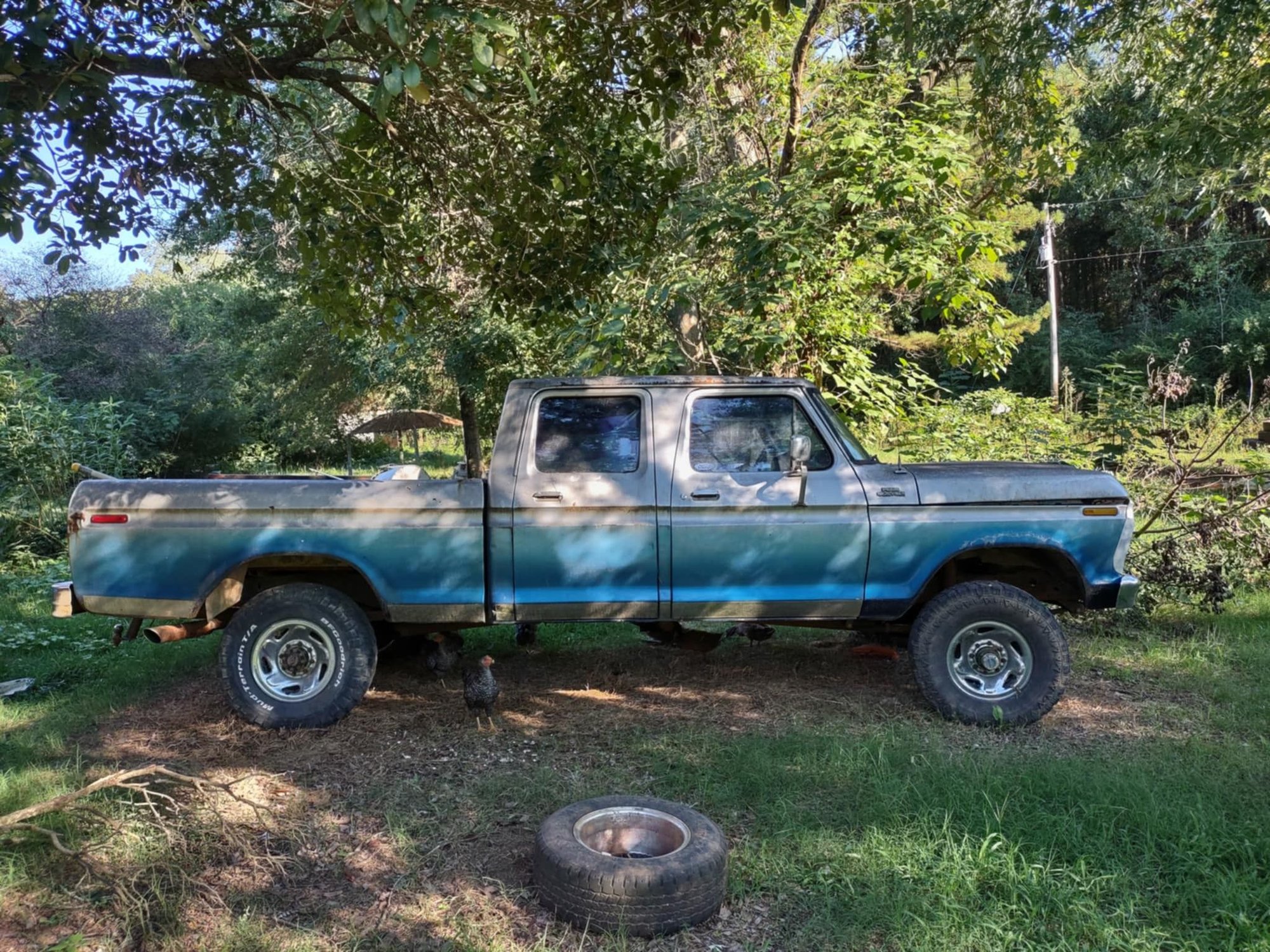

We need pics of your truck
Old Mar 5, 2025 | 12:59 PM
scottddove's Avatar
scottddove
Joined: Aug 2005
Posts: 683
From: North Georgia
several changes are coming. Haven’t had it a month yet.
